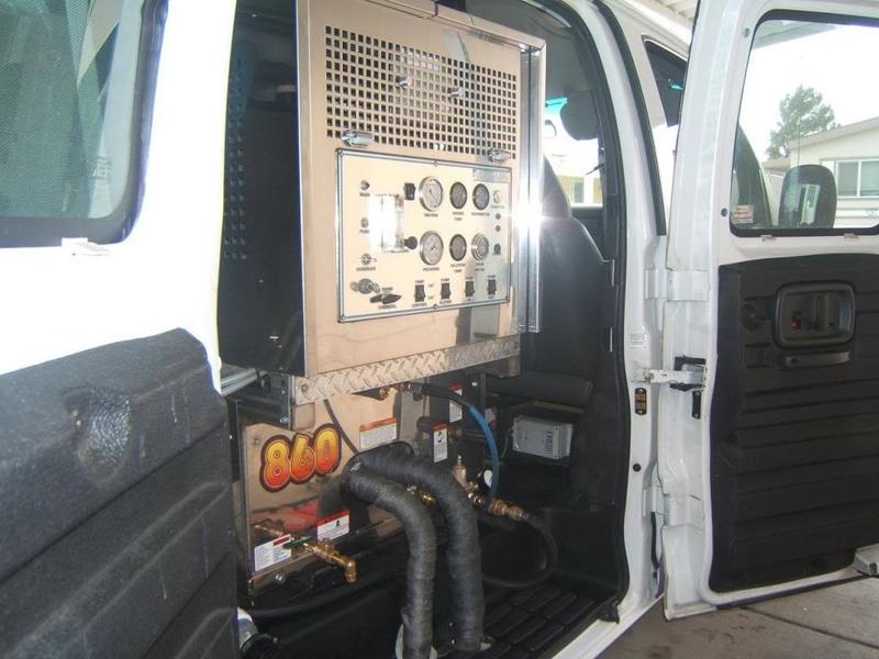

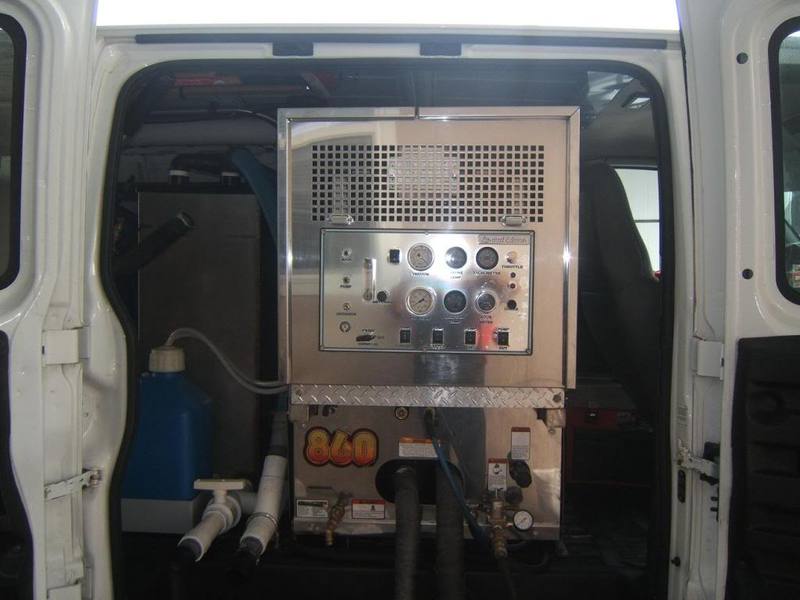

What's the price?
I told him I would post it here to see what you guys thought. He doesn't know what to ask for it. It is in a 2003 chevy 1 ton with 24000 miles, but I'm not interested in the van. I think the van would be worth more without the TM in it anyway. He also has an aluminum 110 gallon fresh water tank, 250' hose reel, aluminum shelf (at least I think it was aluminum).
brace the frame adding multiple supports ensuring alignment will hold and address other issues stated by indy and for a great price might be a good machine.
i will say i have heard a lot about this machine flexes and moves so it will need a lot of support/structural reinforcement but could be a good machine for the right price. i like it because it has my favorite blower in it, a 59.
cobb has a new one sitting on his floor right now, maybe give larry a call about these machines and he used to sell and service them.
toss out a low ball offer of $1000-$1200..see if he nibbles
(don't tell Lockhart where it's at, or he'll get it for $1300)
