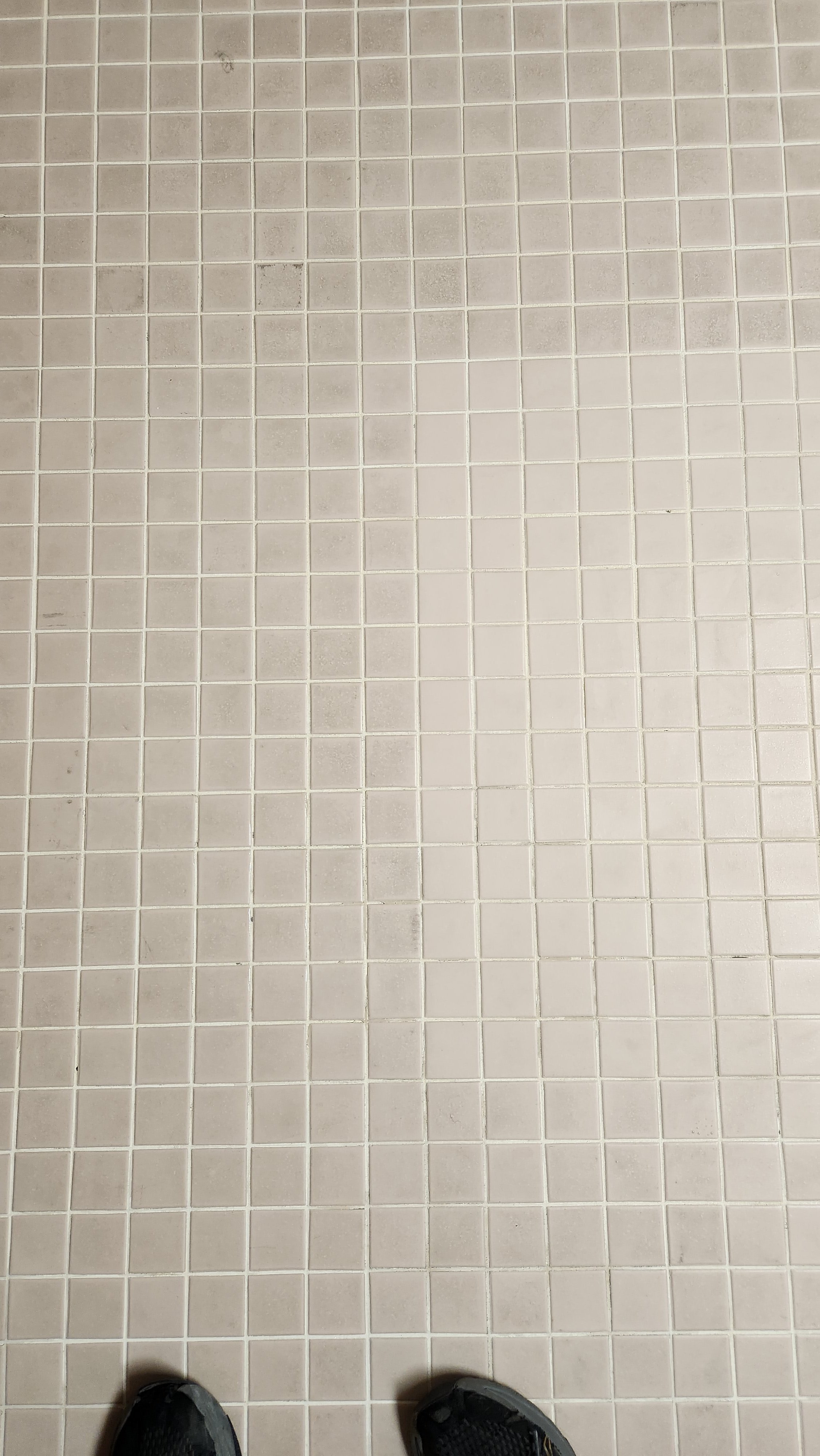

Hey yall. One of our commercial customers asked us to clean 4 bathrooms in their office that is adjacent to their factory where they produce small plastic containers. The bathrooms each looked like this

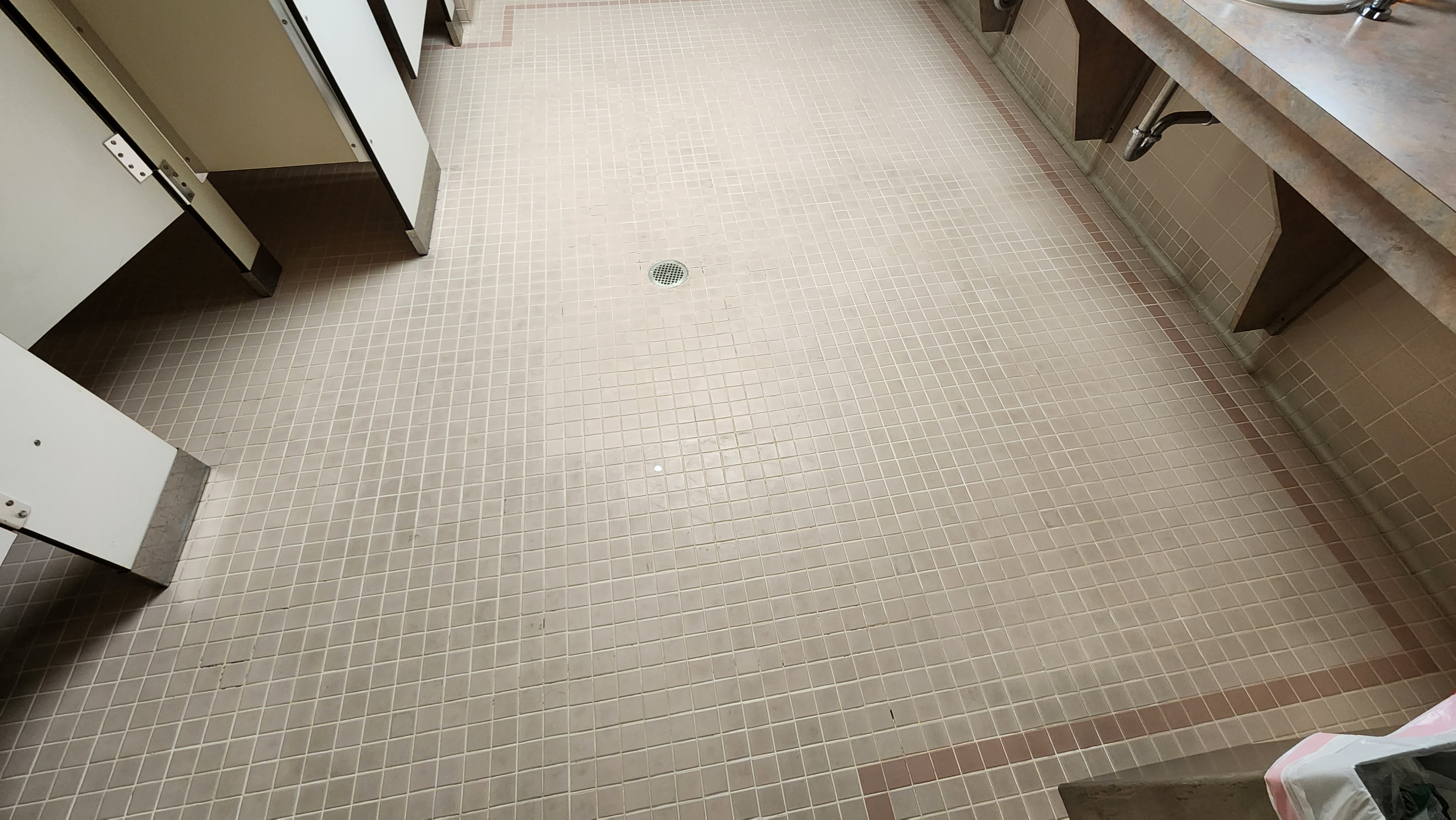

Assuming it was like every other tile and grout job I've done I removed the dust and debris, sprayed it with a high pH detergent, allowed it to dwell for a while, scrubbed with a crb, then extracted at my portables max psi of about 400. Which always gives me stellar results. But the bathroom looked like this after, unacceptable.

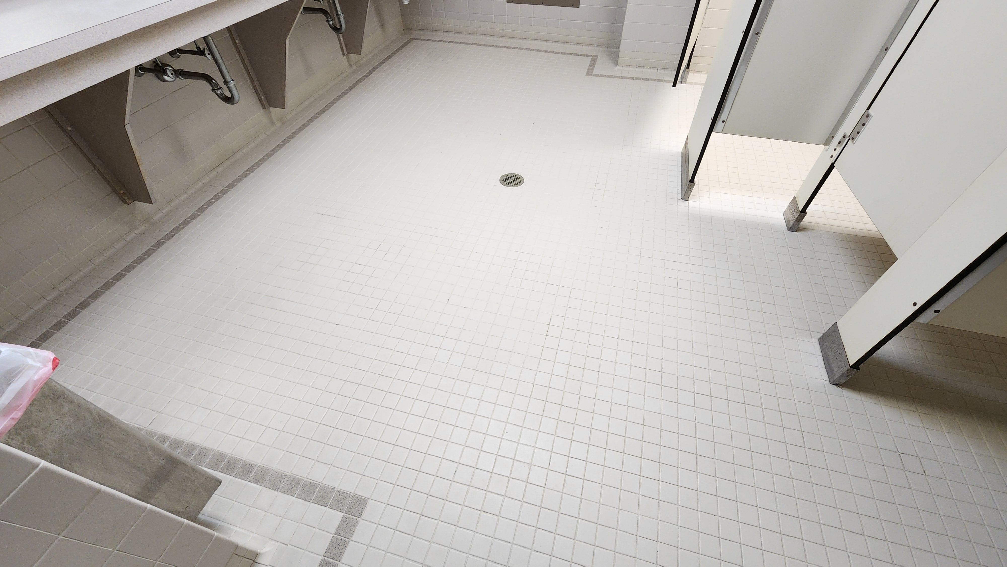

I actually repeated the whole process and turned the heat all the way up and it didn't budge. Surprisingly the grout looked alright but the porcelain tile surface was ugly. Had a few magic erasers in my truck and gave those a try. You can see the difference here.
Seemingly solved my problem. One of those rare floors that just need some melamine pads and a rotary and we're good to go. I rescheduled the cleaning service and ordered the pads. But then it got weirder.

Got back the next week and started in a different bathroom. Cleaned it then padded it with our new melamine pads. Touched up some edges with magic erasers and it looked pretty good!

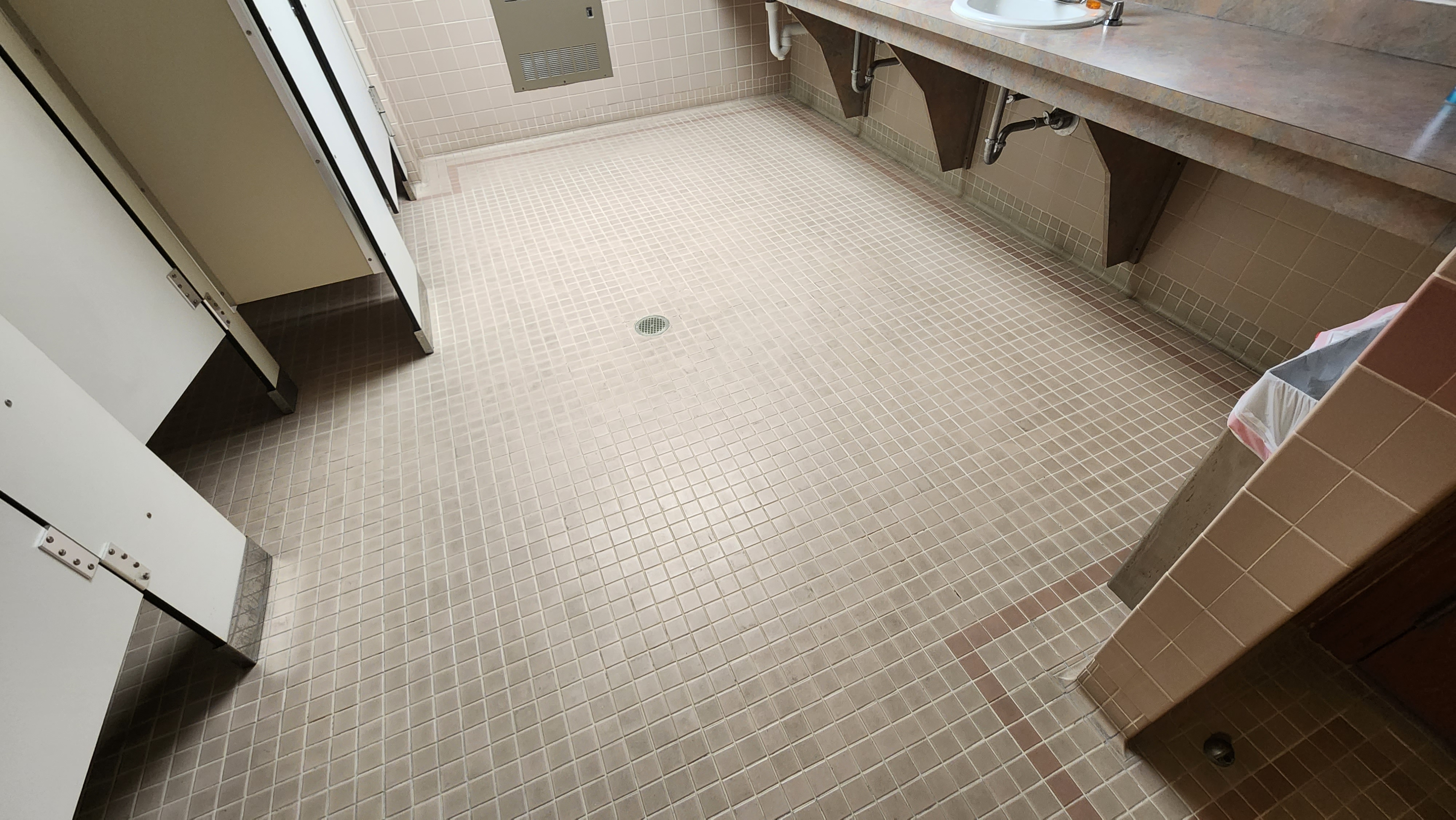

Went to the bathroom we attempted to clean the previous week. Did the same process, but the shmegma wasn't coming off the floor even with the new melamine pads. Despite watching magic erasers just wipe it away previously. I realized after wrestling against this stuff for hours that some aspect of our cleaning process the previous week set or cured the shmegma making it now impervious to the melamine pads and magic erasers. I asked the owner what they are likely tracking in from the factory and he told me it is urea formaldehyde. Did some research and found out that heat cures it 🙄

We discovered that if we cleaned it and didn't hit it with melamine pads immediately afterwards then what was on the floor actually cured and become nearly impossible to remove. If we cleaned it and immediately hit it with melamine pads before the shmegma cured or set it cleaned up beautifully. The bathrooms that we let sit too long after the cleaning took us several hours of experimentation to finally get it to "acceptable" results. I tried stripper, several different solvents, ammonia, a ton of stuff and what finally worked was Chemspec Ink Remover buffed with melamine. It wasn't perfect but it got us out of there a bit after midnight and a paycheck.
