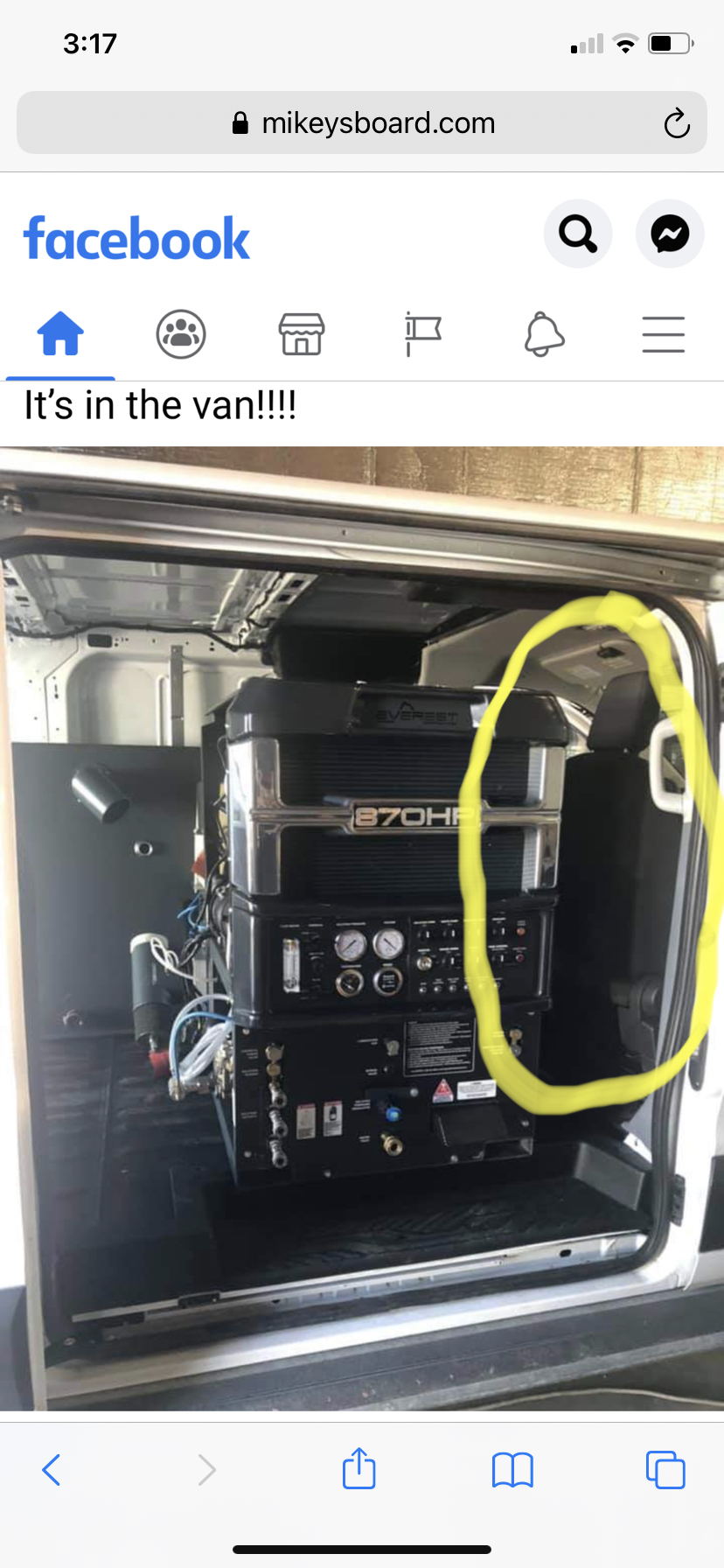

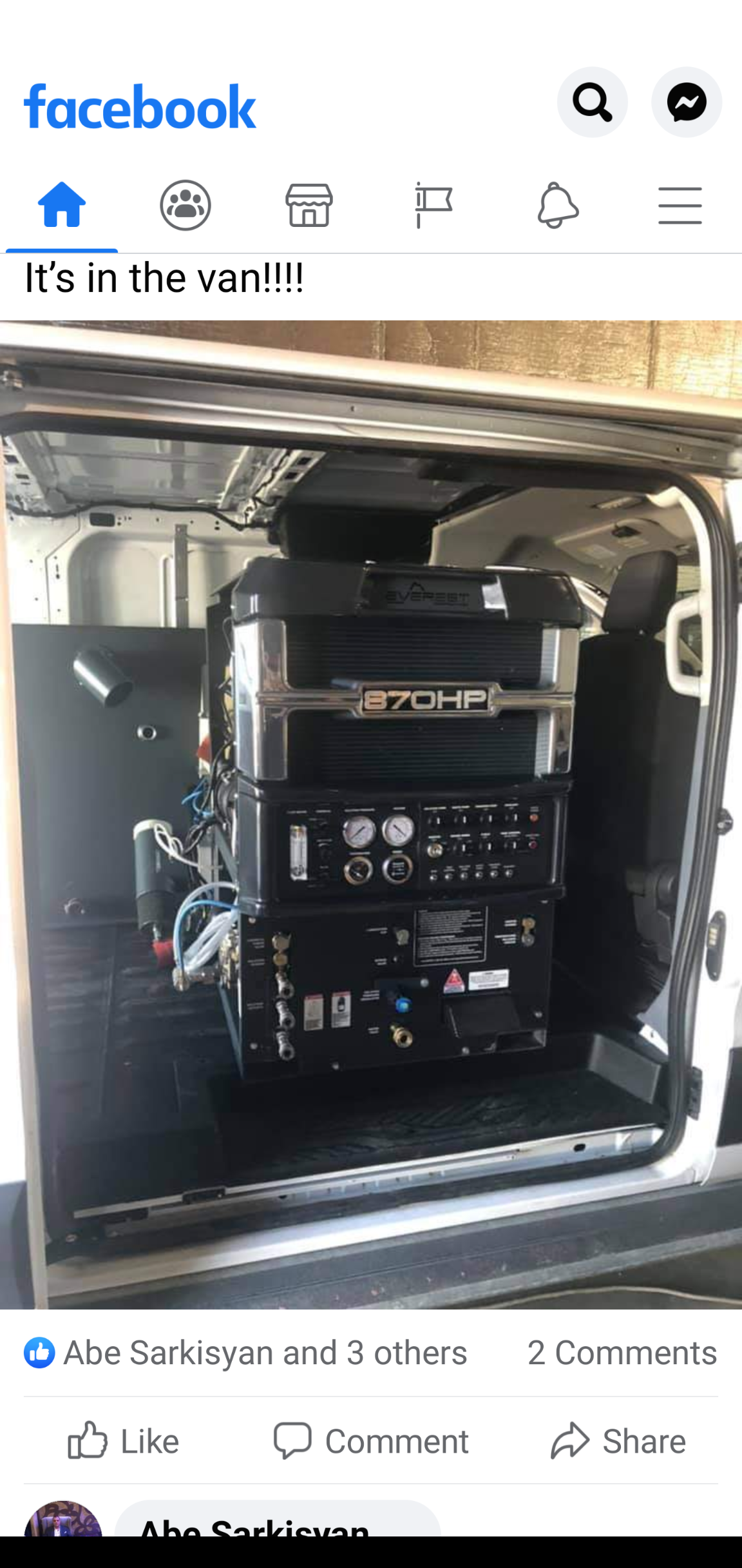

What's wrong with this install...
112,569
112,569
With a low top roof and no driver side sliding door, that poor machine is going to have some serious heat related stress issues
26,988
Looks like it's a little far from the sliding door. Exhaust is hitting the floor. Otherwise it should be fine. Make sure the back doors are open when running. Plenty of airflow.
Johnny
Oct 22, 2006
2,364
La-Z-Boy
Johnny
Maybe the owner set the machine back from the door to give him room to access the van from the side door. That is important to me. He could install a roof vent if he needs more air circulation.
I installed a roof vent in my TCS Chief II
It melted
Try installing away from the heat source instead of directly over the heat source. Try towards the rear of the van.
Heat will still escape and once done with the job and on the road, it will exhaust even faster with windows down until you get back to ambient temp. Then you can run the AC if needed.
