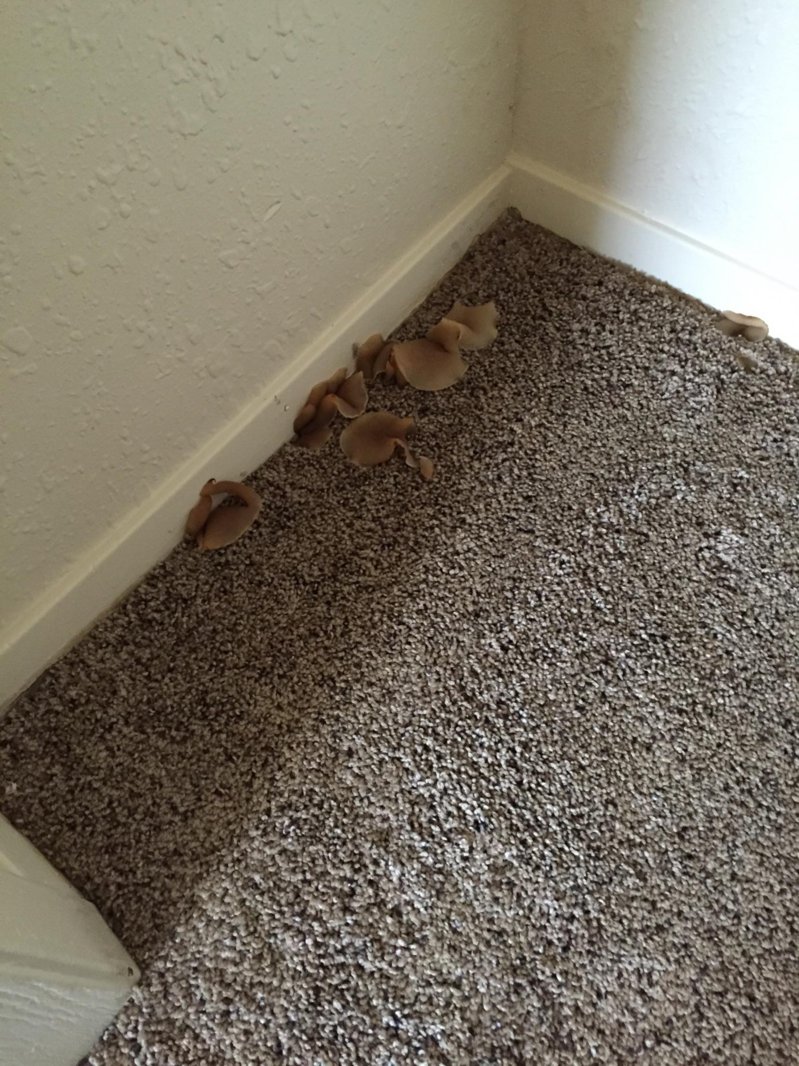

This is a little different, I think:
What would you guys do with this?
I'm not one for mushrooms but the wife eats them.
What does the homeowner want?
Where is the moisture coming from?

I don't know. They just asked me to replace pad in the closet and clean. (Prop Mgmt)

Just remind them that if the conditions are right again the same thing will happen.
They need to figure out the moisture source and correct it.
I think the problem is gone. They just sent me the picture and a work order. This company usually takes care of business.

You could put the plants back in and turn on the lights.
13,372
I doubt that fungus was just from water. Somebody had put something in that closet that caused it. Probably a wet box or cardboard.
At worse if it comes back just replace that peice of carpet.

I went to take care of this job today.
When I got there I used my hydrosensor and found that the pad was wet in a big area. I pulled back the carpet and the sub floor was pretty wet. It has been like this for a while, maybe even a month or more. I didn't want to put an air mover under the carpet and cause any bacteria or fungus to get airborn and make someone sick. So I called the prop manager and told them to get a restoration crew out there.

There was moisture readings in the wall above the baseboards too.
