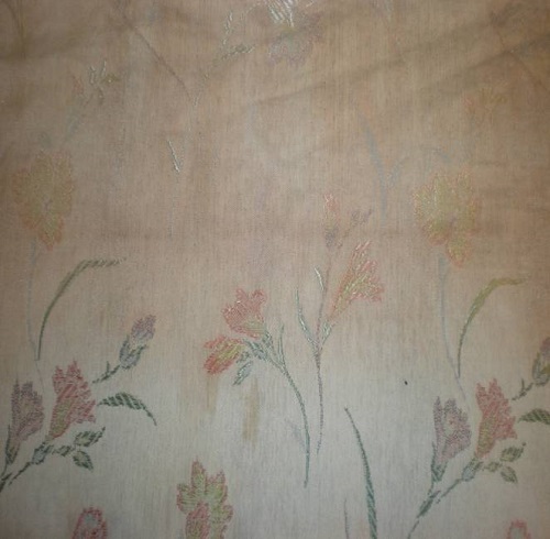

Concern #1 -Prespray Compounds With Aggressive Solvents:
When fabrics are preconditioned with prespray products that contain aggressive solvents, color bleeding may result when the fabric is cleaned with hot water. The reaction of the solvents and detergents with the heat may cause bleeding that will not be evident when pre-testing.
Note: The use of a cool cleaning solution is not necessarily the best answer, since delayed color bleeding can still occur.
Solution:
Precondition with a neutral upholstery shampoo, and then extract with a heated acid based rinse agent. With this method you will often be able to clean sensitive, multi-colored fabrics using warm, but never hot water ..... always pretesting your products and methods thoroughly before use.
"This fabric bled due to a combination of excessive heat and aggressive solvent additives"

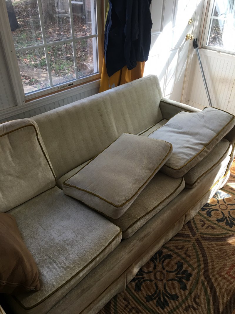

It took that long to wear those lines off the cushions. They were everywhere on that couch

I could take those out if you gave me a velvet brush 30-40 minutes and a jiffy steamer.
I had no clue.
I was so proud of how hot my Prochem Legend could get. My dumb ass was showing off the steam it was putting on that couch. I'm surprised that she was happy with me giving her $300 and taking the couch away. I called someone who'd been in this business longer than me, and he told me I ruined it. This was way before I was on any forum, and my only source of information was taking a class from IICRC.
I was so scared that evening, because my dumbass didn't have general liability either. I'm really surprised I'm still in this business with all the mistakes I made my first few years

I taught myself how to clean upholstery, and this was the first lesson I learned the hard way about 11 years agoView attachment 75041
Well first off that's a custom, after market design enhancement and she should have paid you $300 for improving that ugly sofa. :clap:
