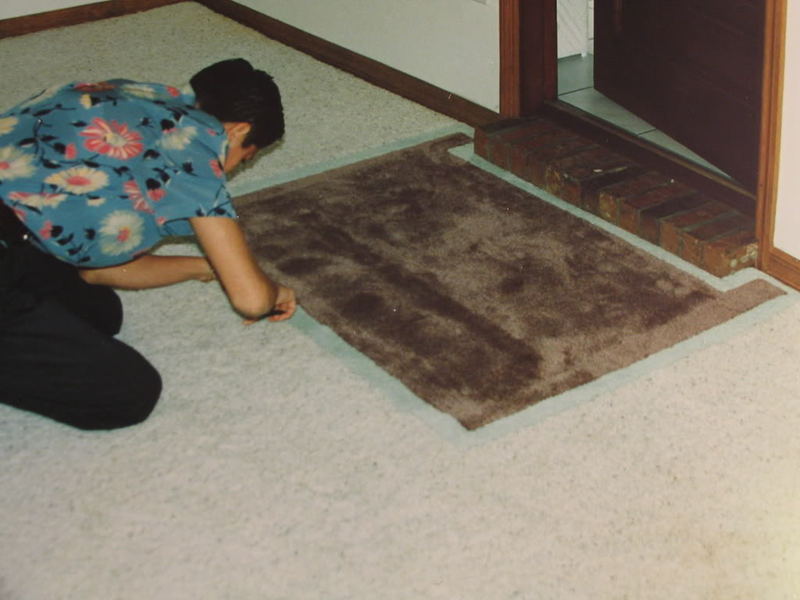

Sometimes we just do not have a matching piece of carpet to use for repair, so inserting a contrasting piece will sometimes make the customer happy. I have three different repairs that may come up that this will be how they will be repaired. Here is an example of something to do.

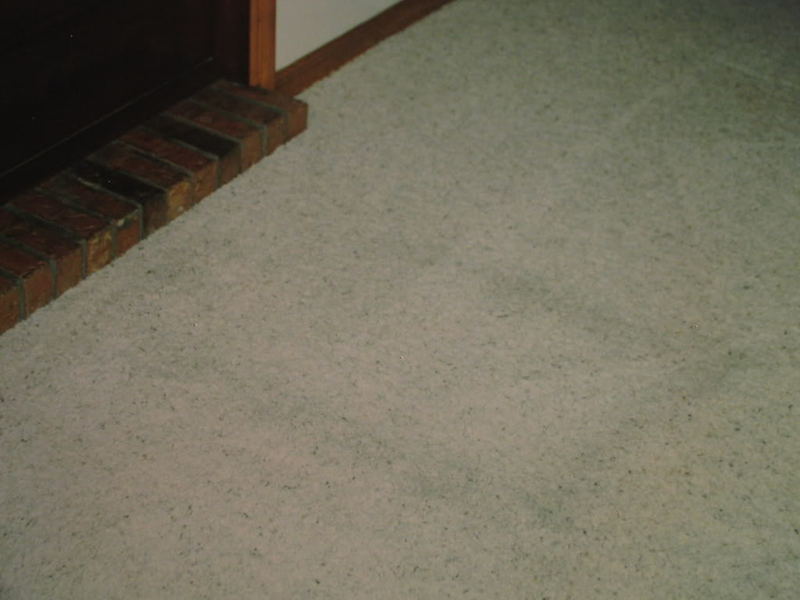

This was an area where the dis-coloration occurred from a rug sitting on top of the carpet, so we simply cut the damaged stained area out, matched the colors to accent areas of the room, confirmed with the customer she would like this and the inlaid this contrasting piece in.
before with the stain
here is what it looked like after

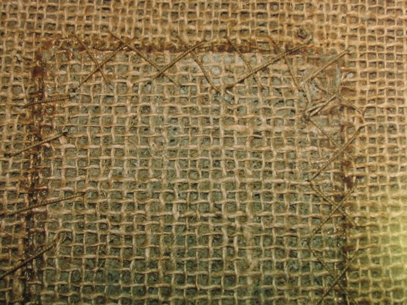

Here is how it was secured

Steve, you have stitched the seams in the photo, can you do the same repair with just the kool glide. Will the kool glide give the seams the necessary strength and durability?
Thanks Andrew
Stevea
Feb 3, 2007
436
Andrew,
This is a completely different type of seaming than with the Kool Glide, it is made from the back of the carpet and used for its tremendous strength in stress areas.
Having said that, yes you can use the Kool Glide but it is very good if you always seal the edges even with the Kool Glide. A properly sealed edge(with hot melt) will hold very well all by itself but with the Kool Glide and the fusing together of both components (Tape and Hot Melt Sealing glue) will give it great strength also.
One is simply from the back side and one from the front side, different forms of repairs.

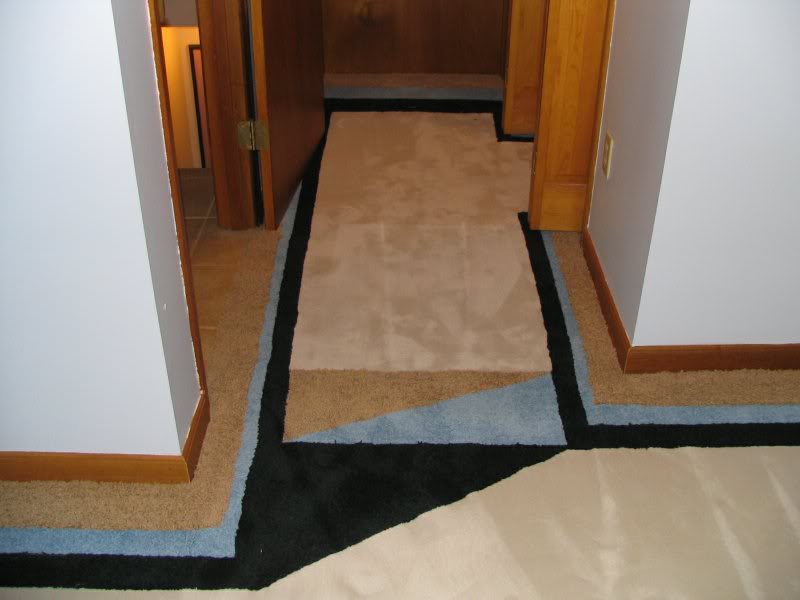

Here is an example of an install we did and the piece of carpet they had was simply too small for the room, so we went and got a remnant, cut border pieces and added to the carpet to make it fit the room, they felt like they got a custom rug out of it

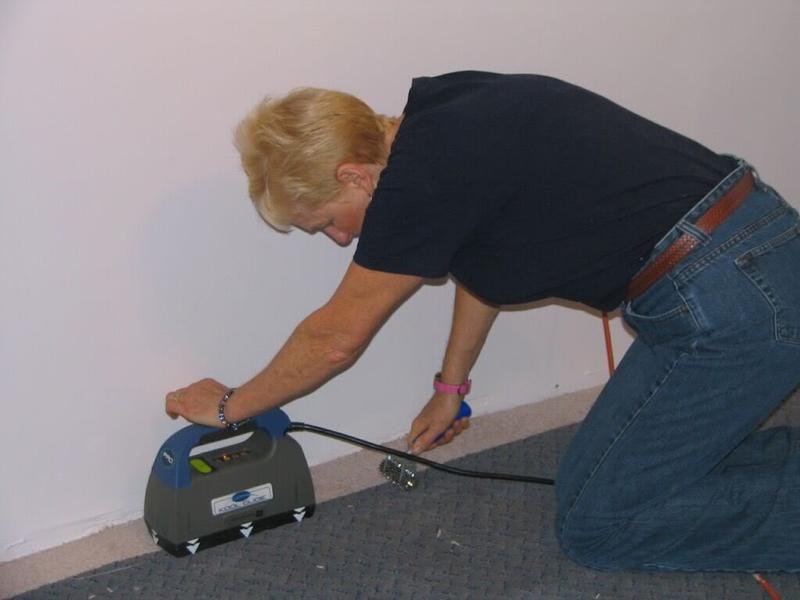

This is my wife using the kool glide, in my family everyone works but me, I get to take pictures.

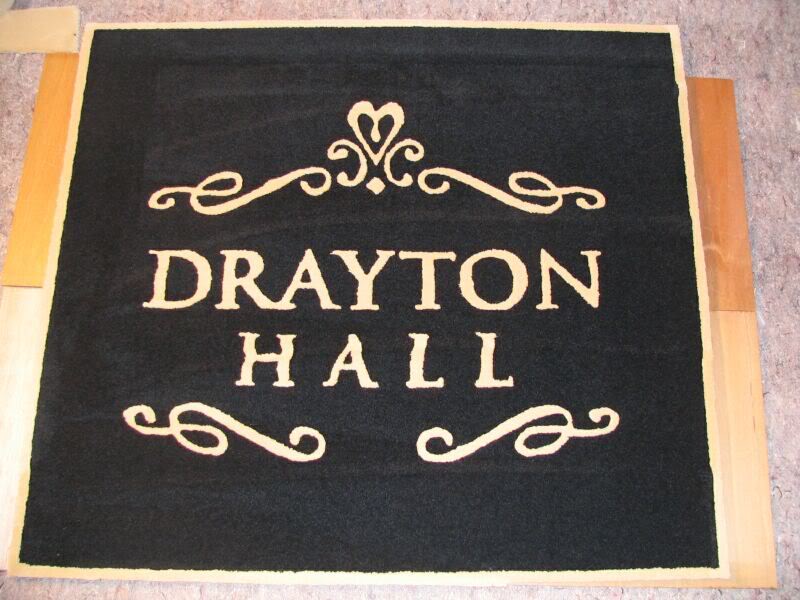

I have been working on a class and video for this. I use it to market myself in some cases. Make a logo rug for some company you want to get into and sell yourself to, present it to the owner or one who has authority and you will get in to speak with the decision maker.
Another benefit, some people just want to buy one or have one made. Here is one I made earlier in the year for an open house event where a real estate broker was selling a 1.4 million home. They had a DJ there, lots of food and on & on, they commissioned me to make a logo rug for everyone to see when they came in, this is the rug I made for them and everyone had to walk over it to enter the home

I'm impressed Steve. That's extremely good work.
Bet you couldn't stop looking at it when you were done.
I gather for things like the scrolls you make up a template and use that for cutouts and donors?

Thank you for such nice comments. Have you seen the one I made for Mikey?
I do not use templates, there are several ways of doing this, as I told Charles earlier I am working on a class for this and video as well as an advanced class that I will share all of this stuff. I guess in a way it is somewhat 'freehanded' to quote John. Nothing magical, actually quite simple.
