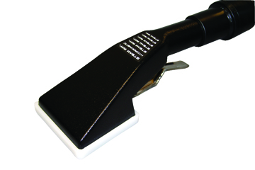

I got prochem wand and stair tool and like them both, I'm looking at prochem uph tool for about $340.00 or PMF high pres internal for about $280.00
Currently using 22" PC stair tool for uph and its killing me

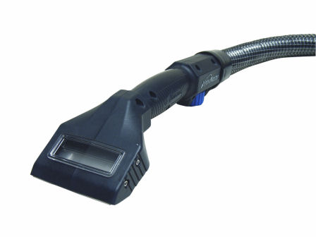

If you can afford it get the hydrokinetic,if not, then go with the prochem,much more ergonomical.
PS-dont tell people you use a stair tool for uph. :roll:

I gotta be honest, a glided prochem tool is way more universal, after that I'd probably go with the HydroKinetic as it's also very universal, in fact I'd probably have a PMF internal jet detailer as well just keep it under 250 psi, then I would have a Drimaster for delicate fabrics.
And as long as your stairtool is glided, ain't nothing wrong with knocking out the flats and doing a little mist and suck on the rear of the couch etc, before you detail it with a hand tool....Just turn down your pressure, and increase your stairtool jetting as a general rule.

CFR - not as ergonomic as other tools, but nothing cleans better.
If I was cleaning a lot of upholstery, I would probably go with the
Hydramaster Drimaster
or Steamway Hydrokinetic
The PC Stair tool comes with 80015's on it, what would you increase to? Also the new PC Stair tools are coming with a single 9502 on them or so the new Jon Don catalog is reporting.
