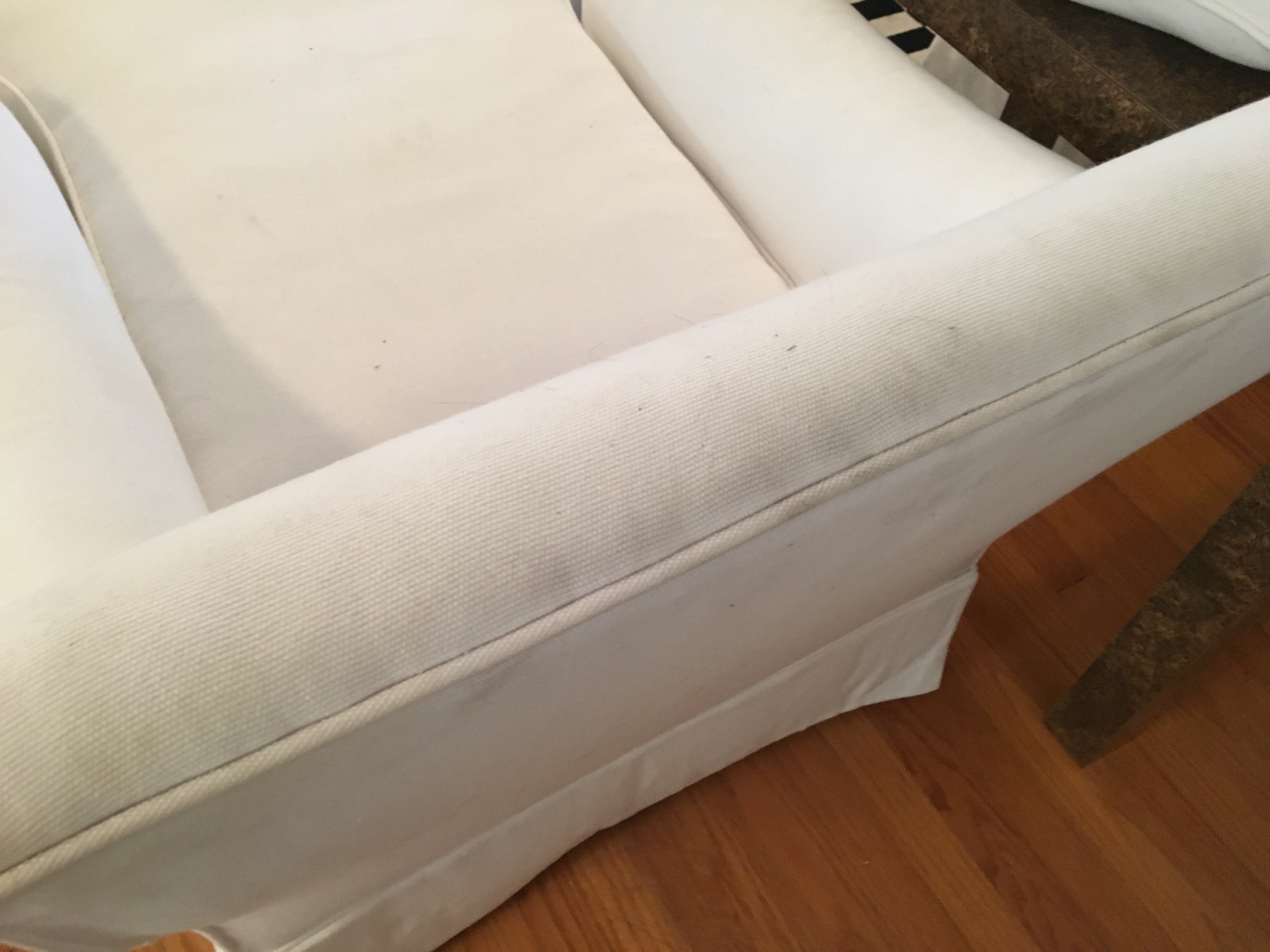

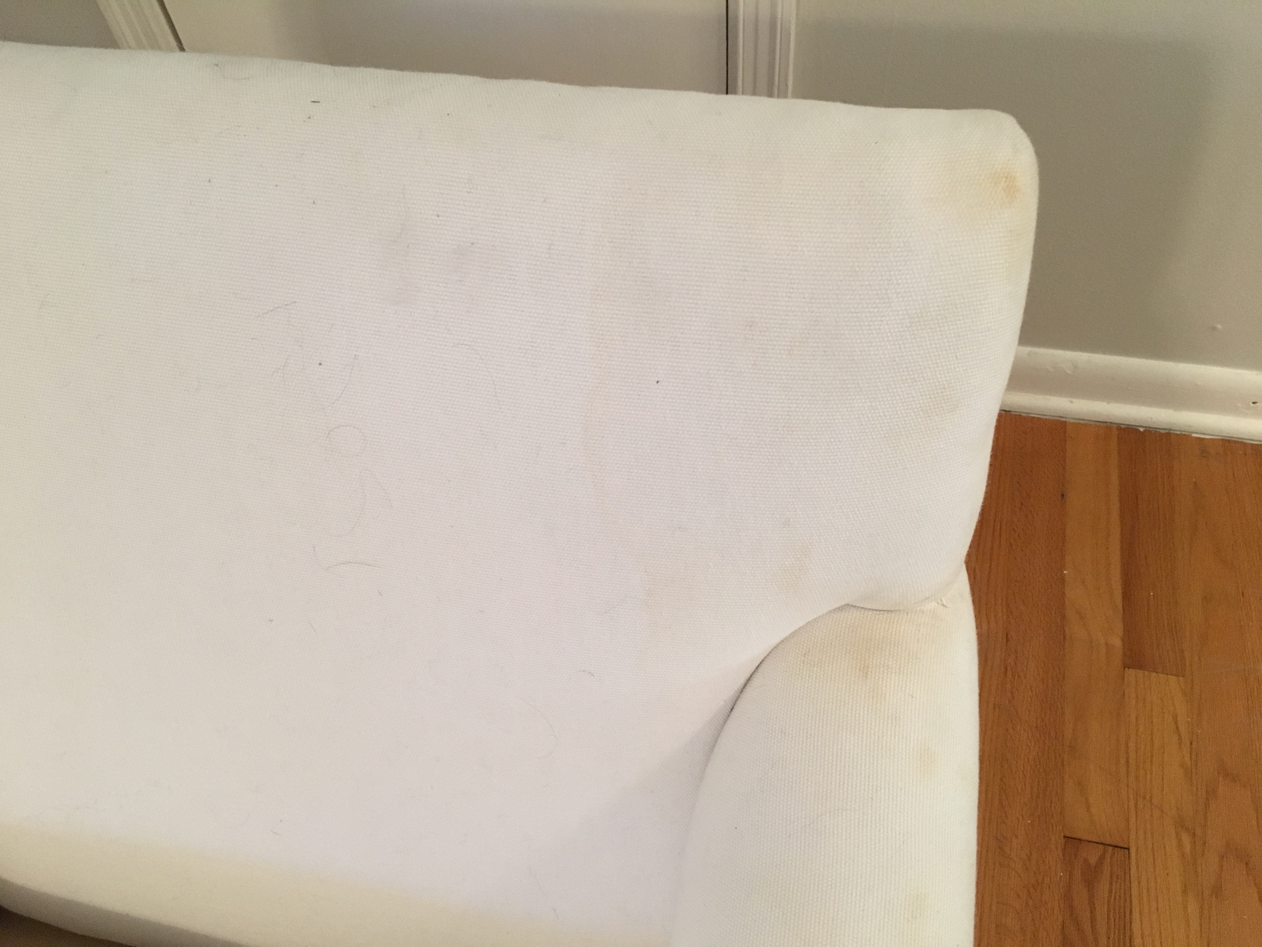

After browsing for hours in past posts, I just need advice. This chair is cotton, scruffy from a recent move. Inside, the cushions are synthetic batting covering a down pillow.
The lady attempted to clean coffee from the pictured corner with Resolve.
She generated the wide, faintly yellow stain pictured.

View attachment 77131 View attachment 77132 After browsing for hours in past posts, I just need advice. This chair is cotton, scruffy from a recent move. Inside, the cushions are synthetic batting covering a down pillow.
