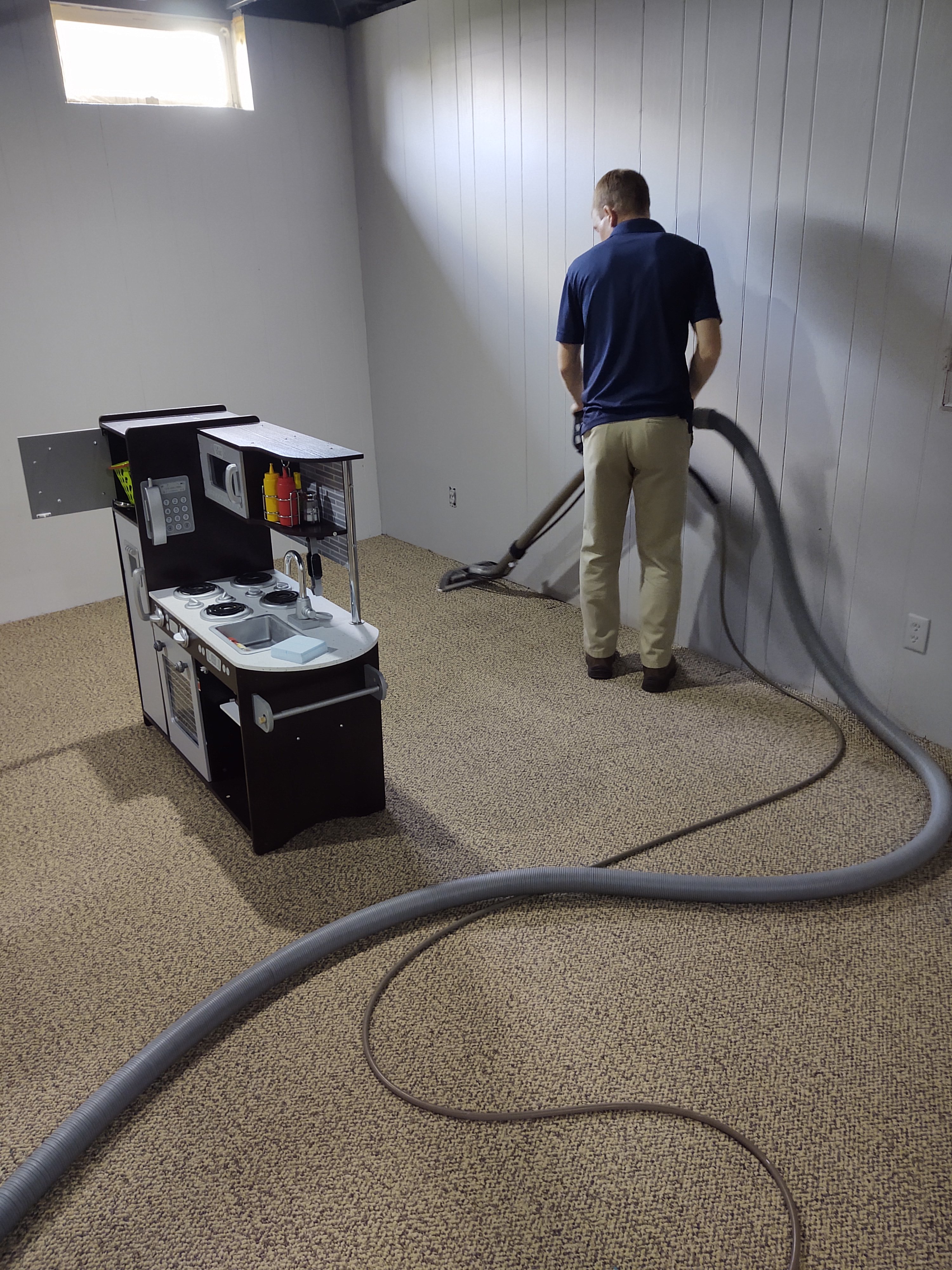

I was able to do a perfect case study today:
Lightly soiled basement carpet. Basically wide open, just had to move and block 3 small pieces. 589 cleanable square feet.
Started a timer AFTER pre-spraying, vac, and using a hand tool to clean around the toilet in the bathroom. Wanted to know exactly how long wanding alone took.
Had an idea of what to expect, but wasn't exactly sure.
Call it an even 600 ft per hour because the small bathroom took a few extra minutes of manuvering. The specifics of this job allowed us to clean about as quickly as we ever do.
