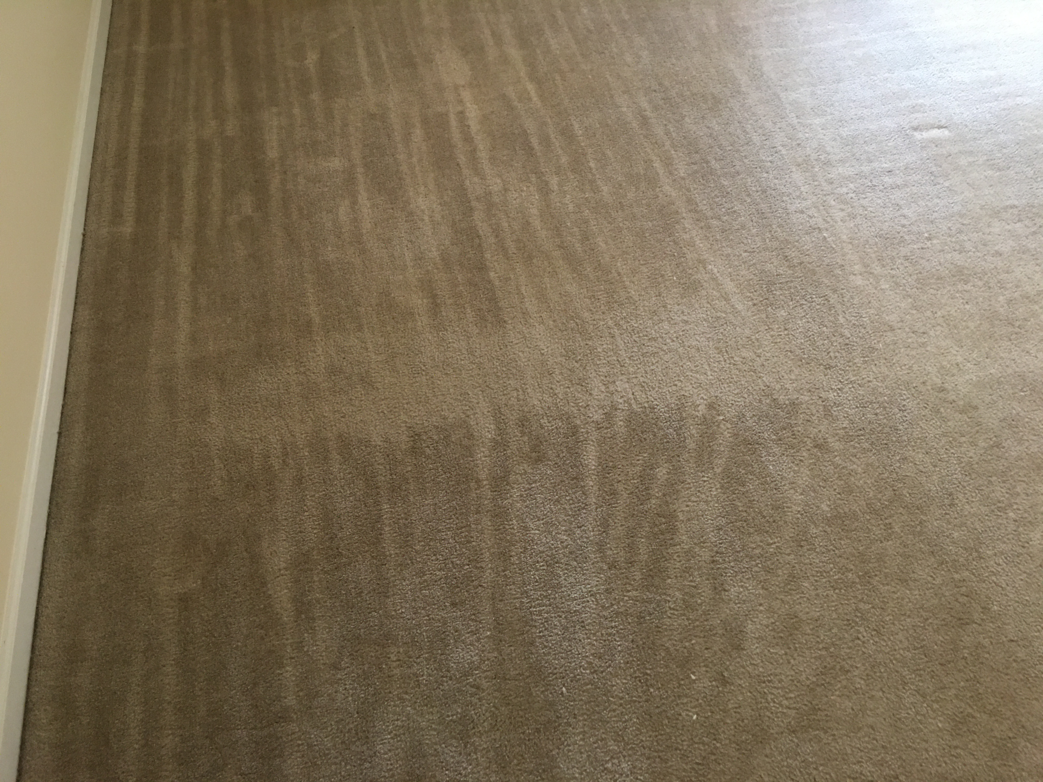

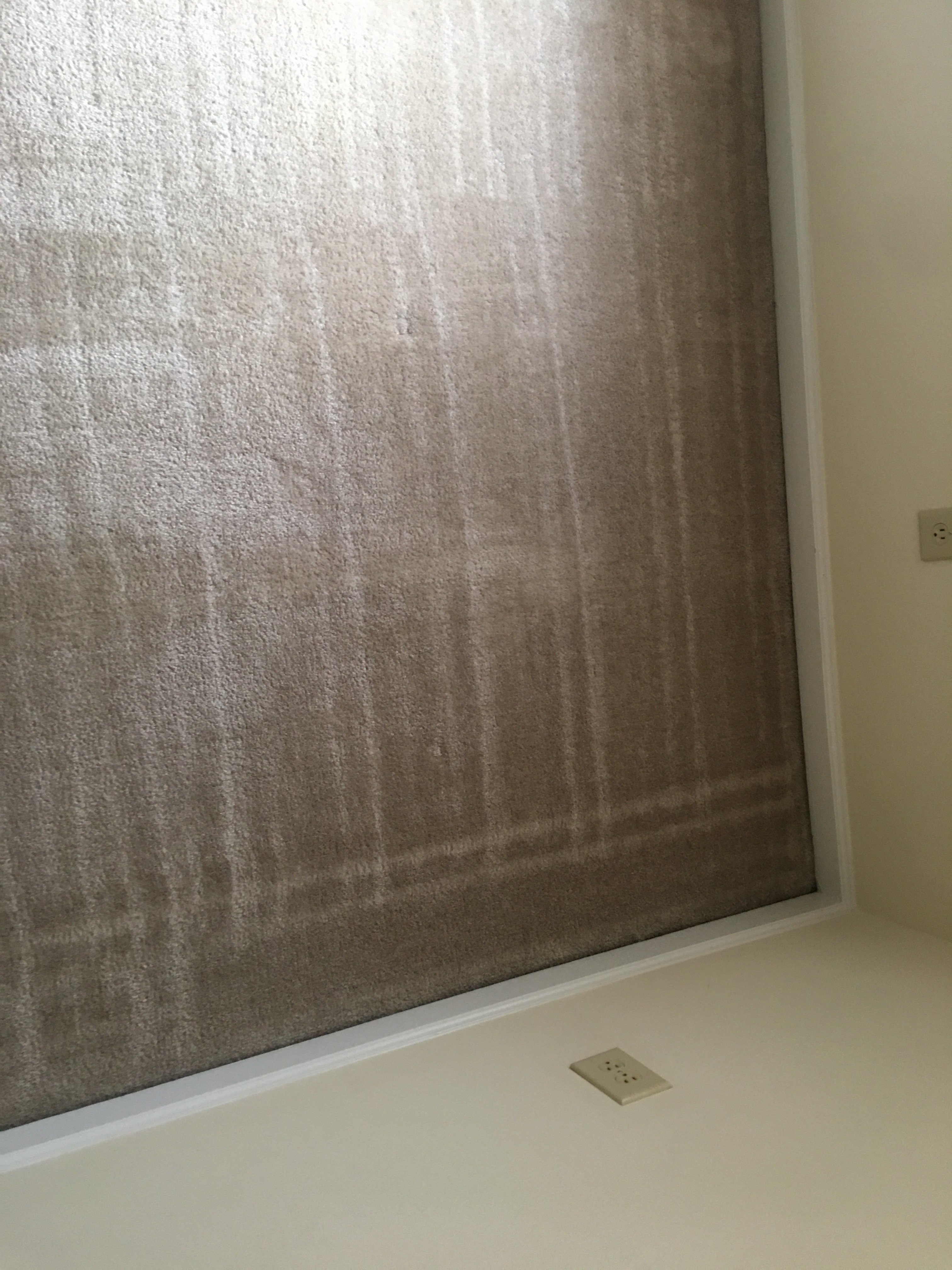

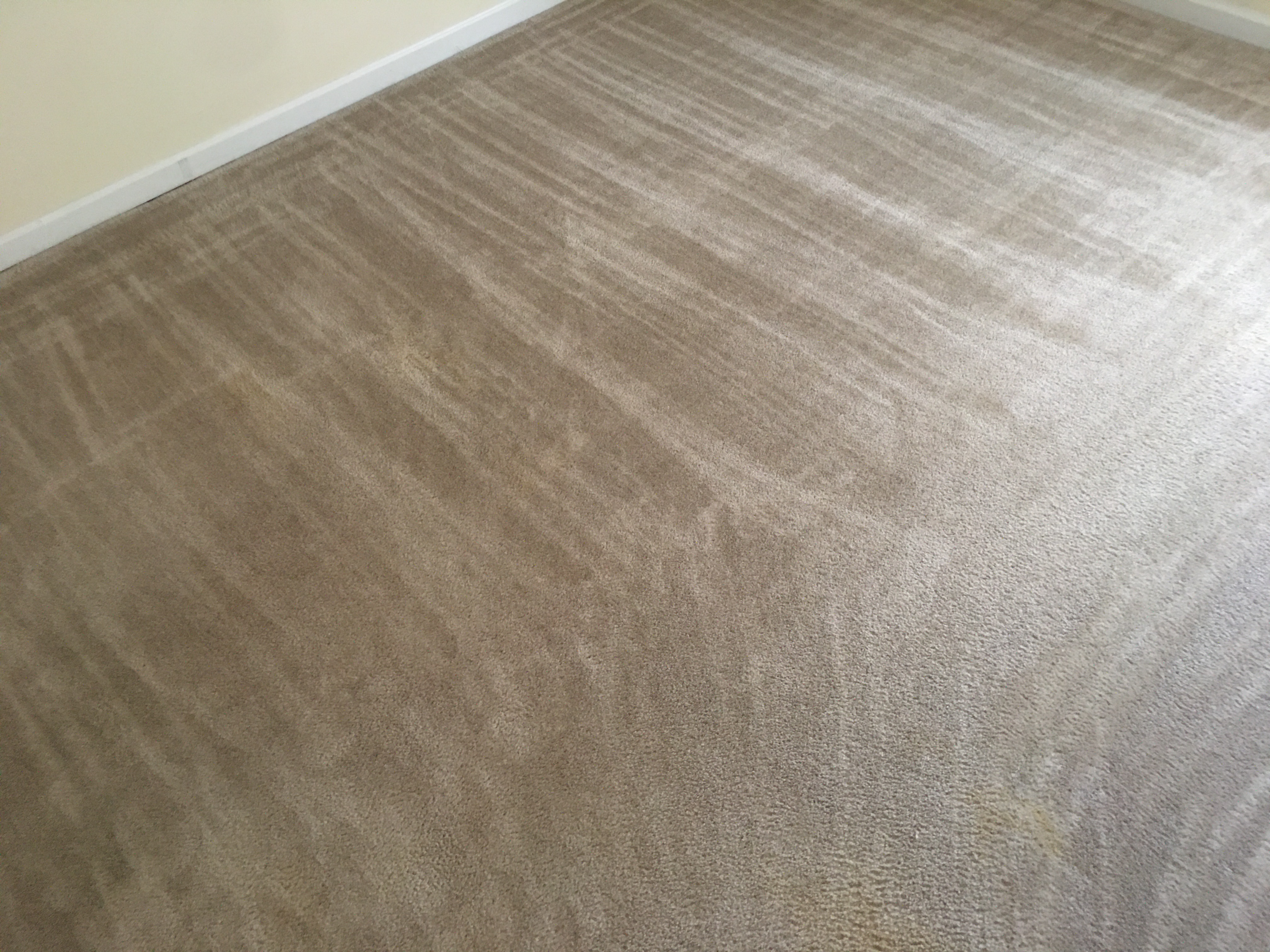

A ignorant lazy tech with a truckmount and wand/RE
Or a ignorant lazy tech with a 175/OP?
List how many ways that both can cause damage and youll see one list will be much longer than tne other.
14,640
Idiot tech with a tm and wand.

I think either method can produce equally damaging results, just in different ways.
HWE- carpet left to wet. Mold, mildew, bacteria.
VLM- tip bloom and other friction related damage.
Which one would be easier to fix when a complaint comes in? What percentage of screw ups are so bad replacement comes up?

Hot water extraction can cause just as much texture damage through worn or misaligned jets rotary extractors with their Jets too close or into the pile, aggressive brush heads etc
Not to mention Marty's favorite cornrowing that happens from CRBing but that can be either method

I've heard and seen it all it seems in over a half a century being around ignorant, lazy techs (and owners).
I would agree that due to ovewetting you can get more complaints with HWE, but actual damage to the carpet goes to the scrubbers.
1. A new brush that hasn't been broken in and damages the carpet/rug.
2. Idiot that uses the drive block itself to try to scrub the carpet, and rips it to shreds.
3. Tech that doesn't lubricate the pad or brush enough and damages the carpet
The above things leave permanent damage.
I have seen permanent damage from jet streaks to be very clear, but not as much as the above three.
Nearly all wetting related issues are eventually correctable.
The way that I would agree with you Mike would be that is is easier to teach a new technician to successfully VLM a carpet than to HWE it, and during the learning curve, you are less likely to get complaints about the work.
