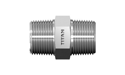

Google made in USA 1/4" brass hex nipple.
Avoid the Chinese crap sold in the big box stores.

This is a misuse issue.
There's not enough material between the I d and the threads that cut deep. It can create a stress facture just from use. The pressure of the hose pulling on it and if you bump a lot of walls moving backwards. Then add the chems and hot water and yes stainless should last longer.

Beside Joe,
Who carries these:
It's the part that gives me frequent fits, as the regular brass nipple that everybody uses to connects the valve to the solution hose, breaks frequently. And is difficult to remove the threaded broken part stuck in the valve. I figure stainless steel is less likely to break.
Find a marine hardware store that caters to commercial fishermen or to shipyards. Shouldn’t be hard in the City.

Most brass breaks because of over tightening in my opinion. Use thread lube or Teflon tape and tighten until snug. Don't keep wrenching on it. Brass is very soft compared to steel .
