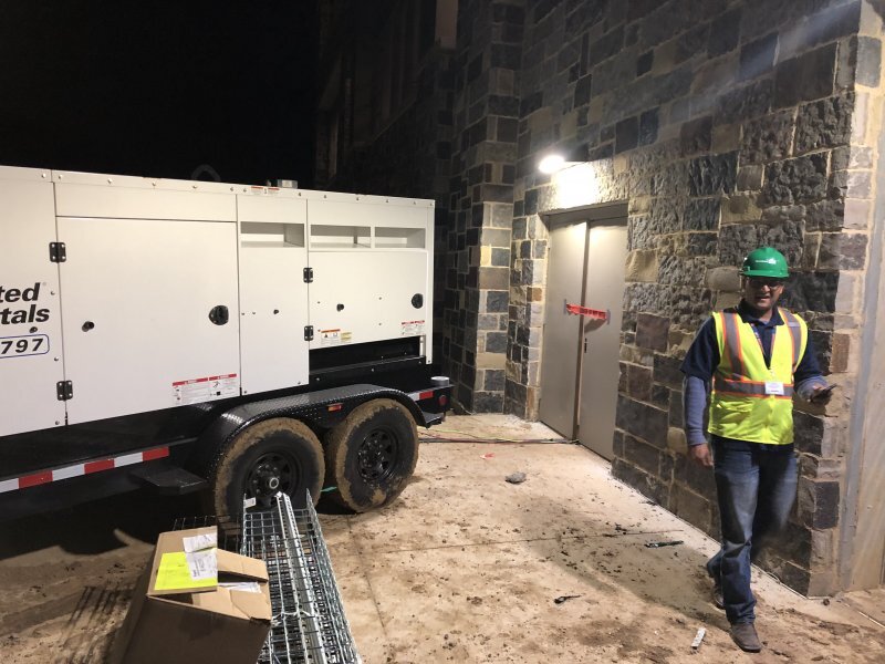

Just keep in mind your gfcis on the Geny will trip at 81 percent load. The tripping willl occur even quicker once it heats up and trips faster..
That is why I asked what the manufacture considers the duty to be and what amps at that duty they say it will run.
Most generators are not full load full 100 percent duty machines.
We use these.

that won't fit in my '73 Pinto hatchback , Lockhart..
You hadn’t mentioned the pinto till now.
I like inverters but you really need even a Honda 3000 just for 20-21 Amps at full duty(always running).
The 3000 is not light and that is why I mentioned getting 2 2000 and run together will get you the 25-26 amps you are looking for.
