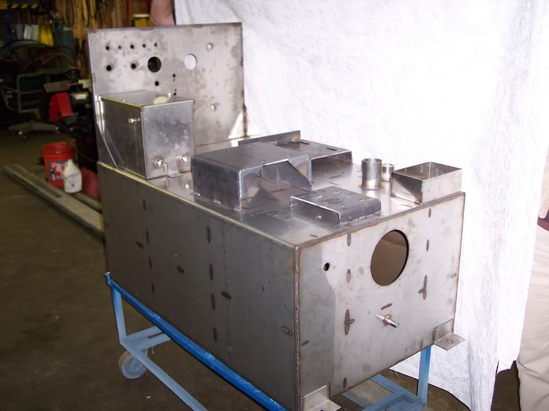

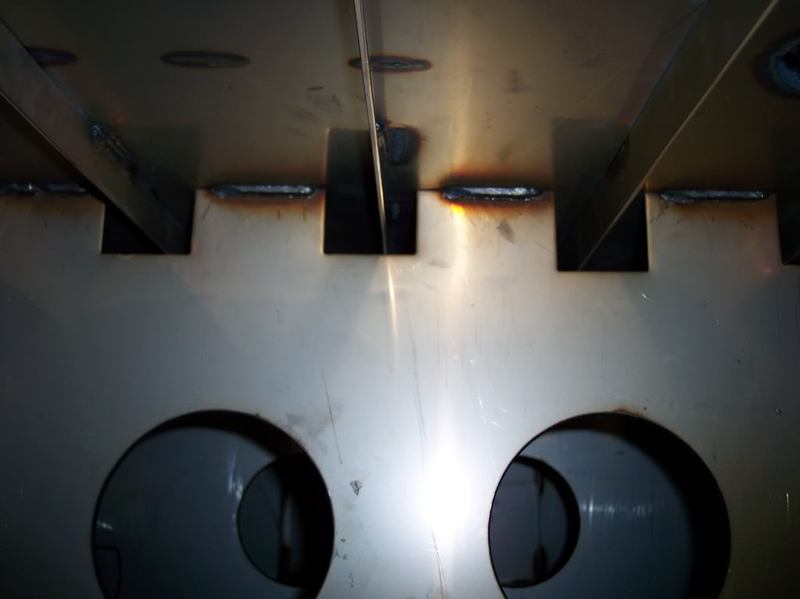

You should see how well built my Lunchpail tank is. Fully welded baffles and supportive ribs every where.

Yes....and mine still doesn't leak.
My dad and I built my stainless steel fresh/waste water tanks in 1984 for our Bane. Still doesn't leak, been in like four vans. It was built out of 12 ga. with the top of the waste tank being the bottom of the solution tank, actually pretty light. The waste tank "pops" a little under the gas TM so I now use it to hold apo water. 150/160 gallons.
Dad has been gone six years now so I have fond memories of the Saturday afternoon we built it together. As fast as I could shear and or bend the next piece of it he was tig-welding it into place. Also my first day on a plasma torch, for the opening in the top of the solution tank to allow heater coil maintenance. The tanks curved to match the van wall and contoured over the wheelwell to maximize space in the truck.
I smile when I hear the hype about the expense of fabricating the Vortex, and the like. I could get it built in Podunk KY, or many small towns in America for less money and with less hassle.
