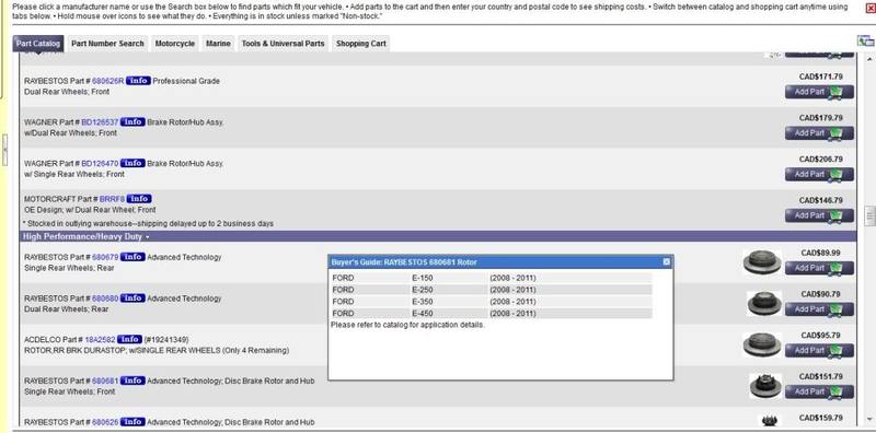

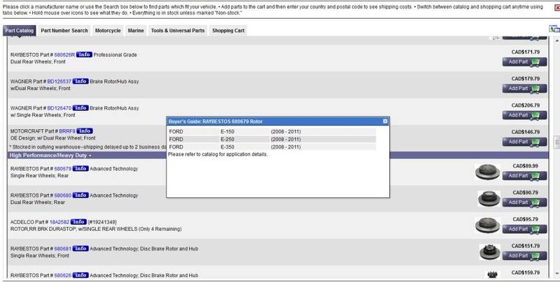

Ruff Hewn":xol5tp9e] On Fords they're same brakes and drive train . [/quote] They are different. [url="http://www.autopartswarehouse.com/sku/Ford/E-350_Super_Duty/Centric/Brake_Disc/2010/Base/CE121-dot-65126.html?loc=Front said:
http://www.autopartswarehouse.com/sku/F ... ?loc=Front[/url]
http://www.autopartswarehouse.com/sku/F ... ?loc=Front[/quote:xol5tp9e]
one of those is for a dually Super Duty Bob
not sure if they're the same as a standard 1 ton
and don't feel like searching parts stores applications ...
you can if you want
B
Bob Foster
Wow, you're right Larry. Here are the part numbers for rotors on 2010 Ford E series front and rear for single wheel rear 1 tons.
