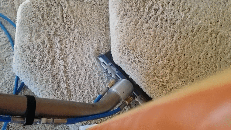

After five days of use I really got in tune with the swivle action.
Tom's design is very different than mytees in that the jets work from any angel. The mytee design would put the jets into the carpet and create back splash mess.
Toms swivle is also much stiffer, so cracking a side to sick up a dingleberry is doable.
The subtle action of the tilt really saves time and energy, especially on staircases. No the head does not flip to do risers

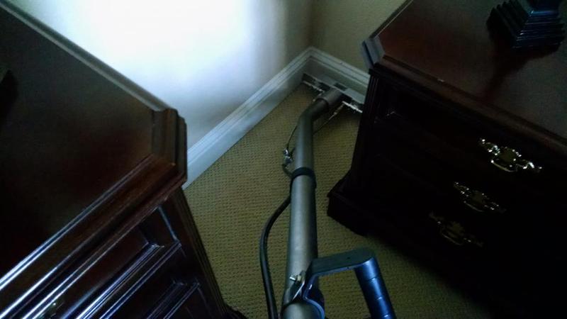

This is the thing, a swivel is not a must have item and I KNOW that, is it something you need to run out and get...NO its not. I can say it does have some advantages...and the more you use it the more you realize as small as they are they are helpful, it makes some things easier. It still sucks bending down to get under things and the truth is that really is the least I use it for.
It is more noticed in this type of situation
Or when your working your way down a long hallway...you are not bending your body so you can clean the wall your butt and back are against...you stay in a much more comfortable position and the wand stays square to that wall.
It is just a wand and it does take a little to get used to, but it does help in little ways that you really don't realize till you try it.

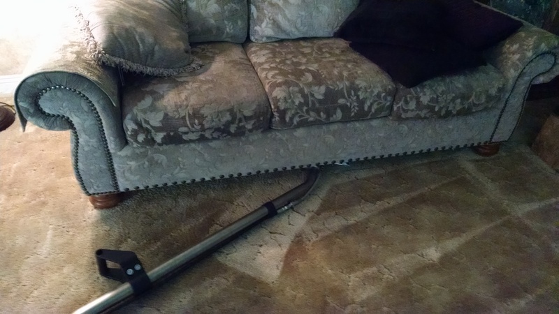

I know the head resembles to PC ti and it does, but the inside is not the same no inner attic or wings, I liked the height of the head as it is the lowest profile head out there making, it the best size to get under things when the swivel is needed. Like getting under this couch, now I wasn't trying to do some amazing job under it but this room was pretty packed and it just saved me from having to move other things to be able to move this beast of a couch it was very well made and heavy.
