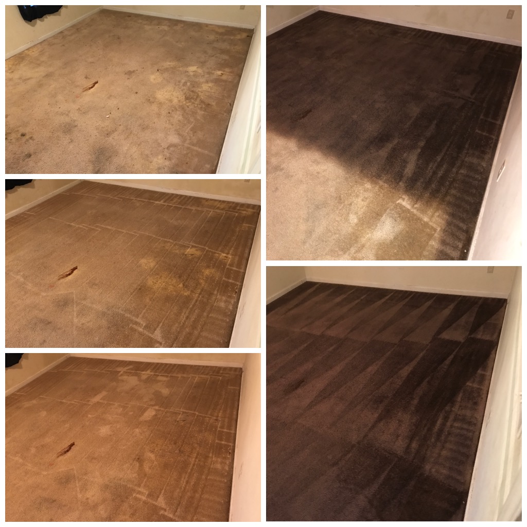

I have been dyeing for 20 years. I’ve had Chris’s class too. I took the class to learn some of the tricks on polyester but 80% of the info I knew already. My YouTube channel has many videos of me doing full room dyeing

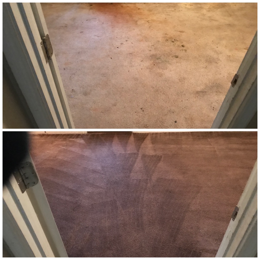

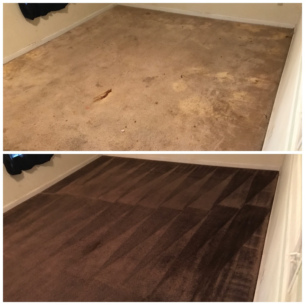

2542D06D-4888-4835-9E07-C732E35C85D3.jpeg 6E3D85C6-2C79-4623-B376-042C702833DC.jpeg 035DEAD2-A9DB-4A42-B7B6-B87A7FADD7DA.jpeg 0D41942B-8DD5-435C-A70B-2E5D938191AF.jpeg EEDBA1F9-3EF2-4B97-92A7-77B7C2145748.jpeg F813D3B7-4F67-4D44-9FBC-629C9667F812.jpeg A4942E4D-EF04-4119-B2E2-41562F207681.jpeg

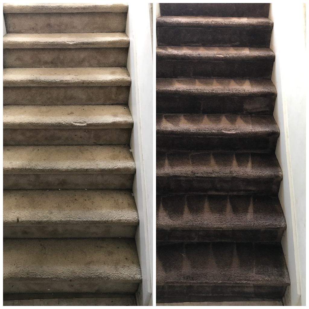

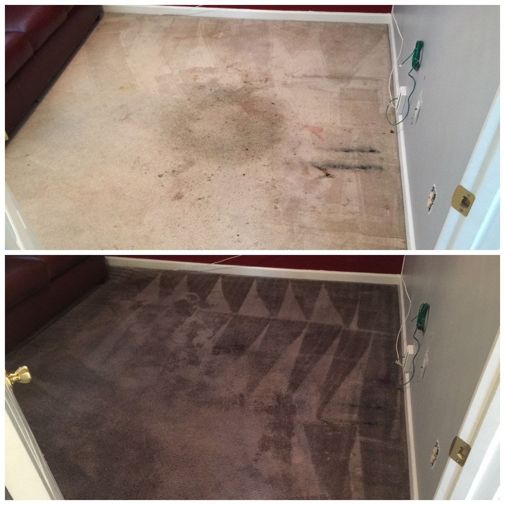

Me dyeing stairs
30,566
no offense Chandler but when groomed, most of those rooms will still look like stained up azz ...just a little less stinky and darker color azz is all
what kind of per room charge are you getting for that compared to a landlord installing new $1.60sf poly/PET cut pile?
( cost here for new installed w/padding)
Reactions: Chandler Thompson
Heart of Dixie
I guess I expected a spray shield along the baseboards. It also is a LOT more liquid than I thought; those steps are dripping. Do you recover the excess?
Mar 8, 2017
39
Atlanta
Chandler
Non taken. $150/ room. 2 room minimum

It’s wet because we have to clean and reduce the ph for maxim dye penetration.
