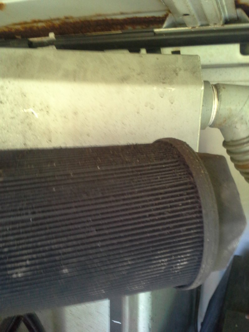

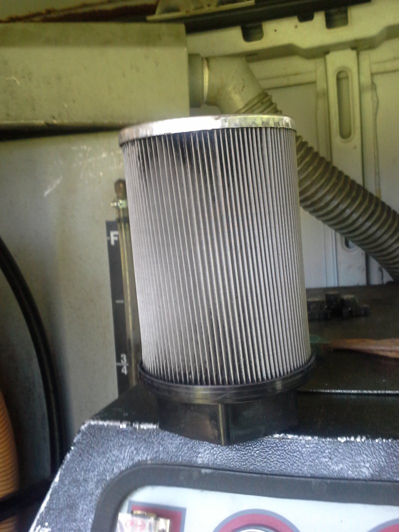

I've noticed my wand screaming a little less and now I'm noticing less suction for sure. Today I was pulling 10hgs before I even get to my wand. Filter is clean, I've greased the blower recently, lid on waste tank is tight. Any ideas?

If its pulling a load without a hose attached or a wand on the floor you have as Lee said, a blockage. Could you have sucked up a rag, a pencil, a popsicle stick, even a Bobby pin. Maybe when you unhooked the wand it sucked up something.

send a golf ball through your hose and that will solve any blockage in there. To check for leaks at the truck, pull off your hose and plug the intake with your hand and listen for leaks. It should just bog down your blower.

That's what I would guess too. My Cleanco (blower protection) filters need to be hosed off about every other day.
Yeah, and if you haven't cleaned them in awhile you may want to let them set in a bucket of hot water for some time first.

I'll have to try that. I use a Devastator to catch most of the stuff but I can definitely feel a loss in suction after a day or 2.

Vacuum filter need scrubbing with a brush, new foam seal on the lid my 405 is amazing again.

Never...NEVER...scrub yor filter....run water from inside out at pressure...
