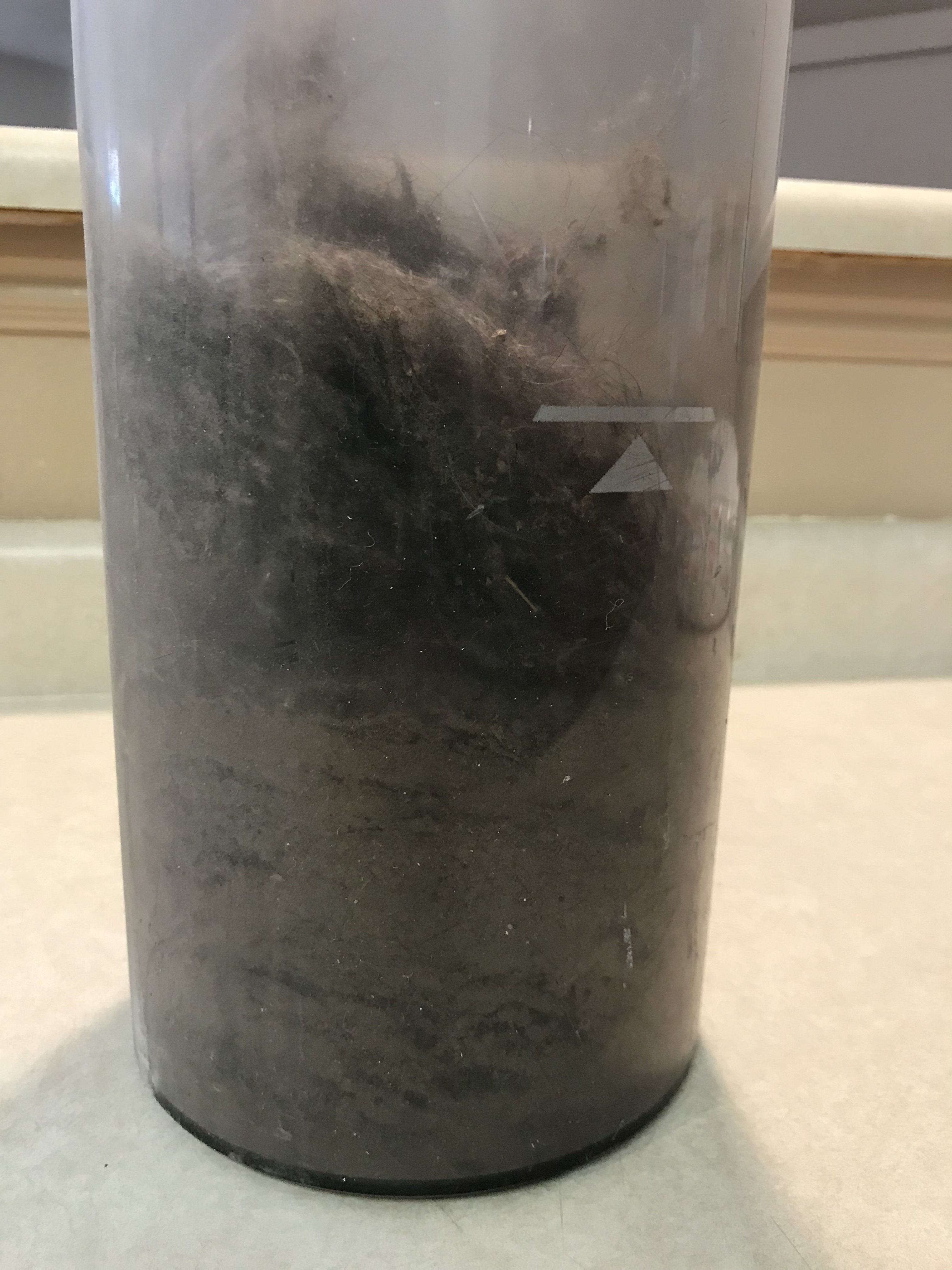

All of that material is feeding and breeding grounds for the bacteria that leaves a place with a "doggie"/"dirty sock" odor after cleaning.
