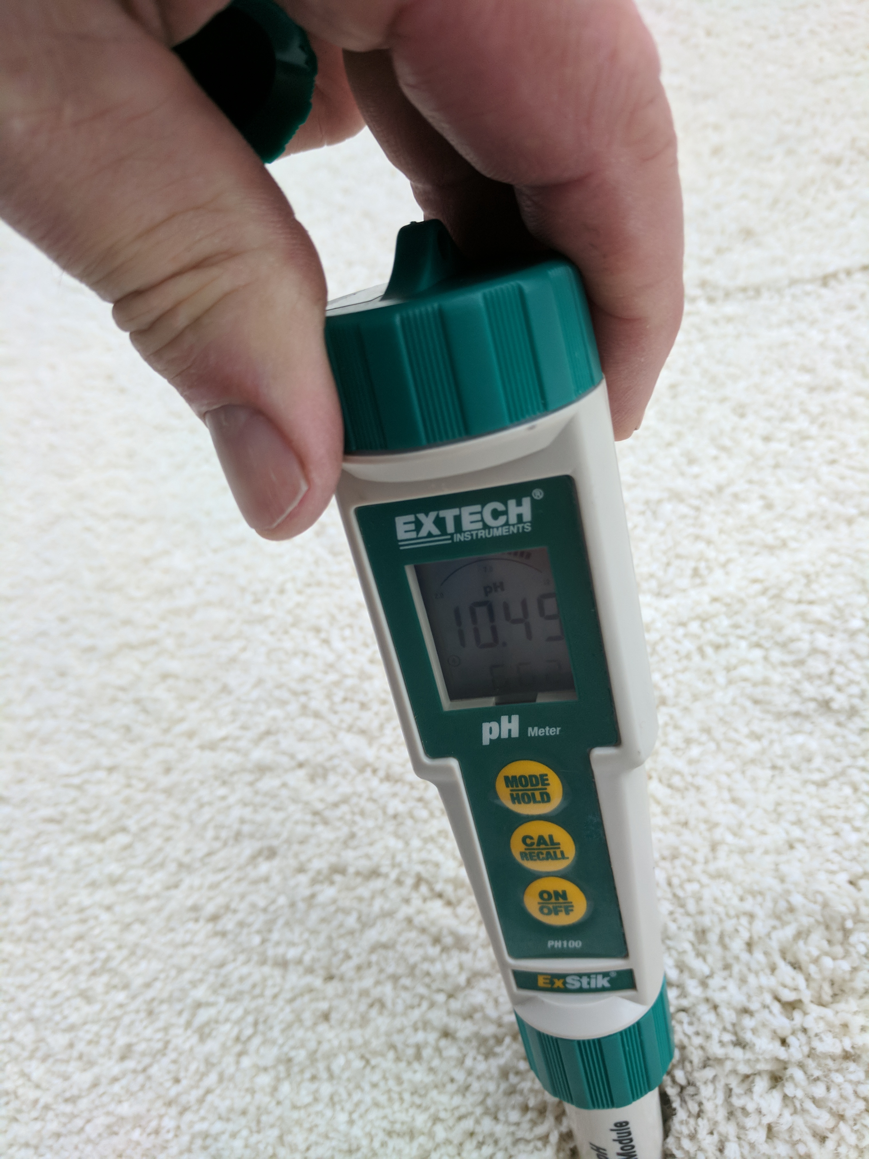

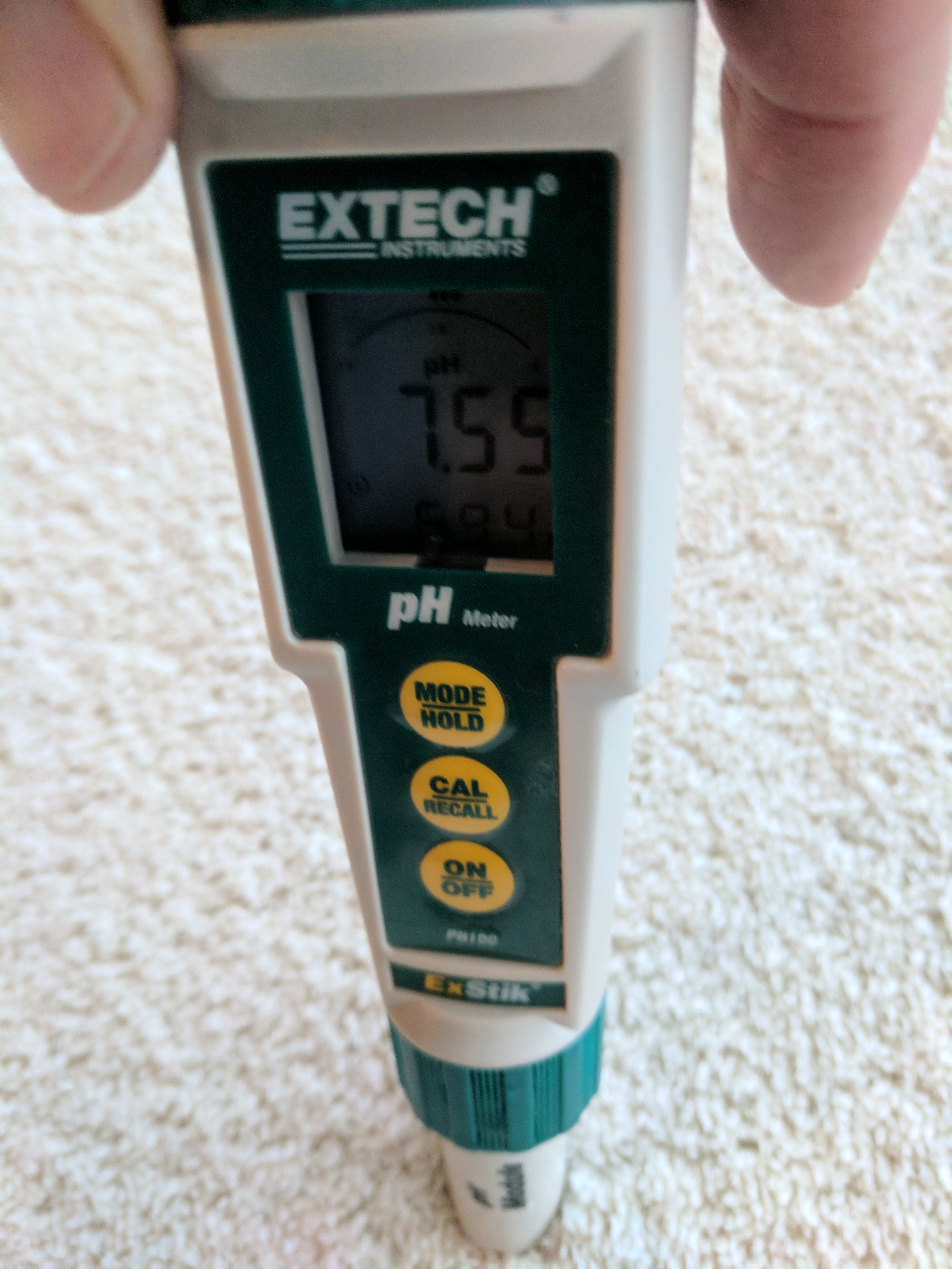

Cleaning this 60 ounce nylon today and thought I would do some ph testing. Not heavily soiled, I'm really there to do some spot removal. Carpets were cleaned by me 6 months ago. Presprayed with code Red (12ph aprox). Rinsed with procyon plus powder (10ph aprox). First pic is the ph immediately after prespraying, second is 10 minutes after rinsing.

We did a similar test on a different carpet with high levels of soil. We pre-sprayed with Flex Powder (12 pH) and rinsed one area with water (pH 7) resulting in a pH of around 9, we rinsed another area with Flex Ice (pH 5.0) resulting in a pH of 7. If I remember correctly we did a video using the same pH meter)). Two points to consider, effective rinsing removes a lot of pre-spray as well as the rinse residues itself over water alone. Also pH does not reflect the total alkalinity of any given pre-spray. We did a recent test that one product that was twice the alkalinity (this was not shipped as a corrosive material) of one of our products, but had the same pH of one of our products (which is shipped as a corrosive material).

Normally, I would not use code Red on nylon but I was correcting some coffee stains and wanted to see the effect. It reduced the staining by about 50%. I still had to apply a 2 part peroxide treatment to get the rest. The point is, rinsing with a 10 ph product still left the carpet close to neutral.
