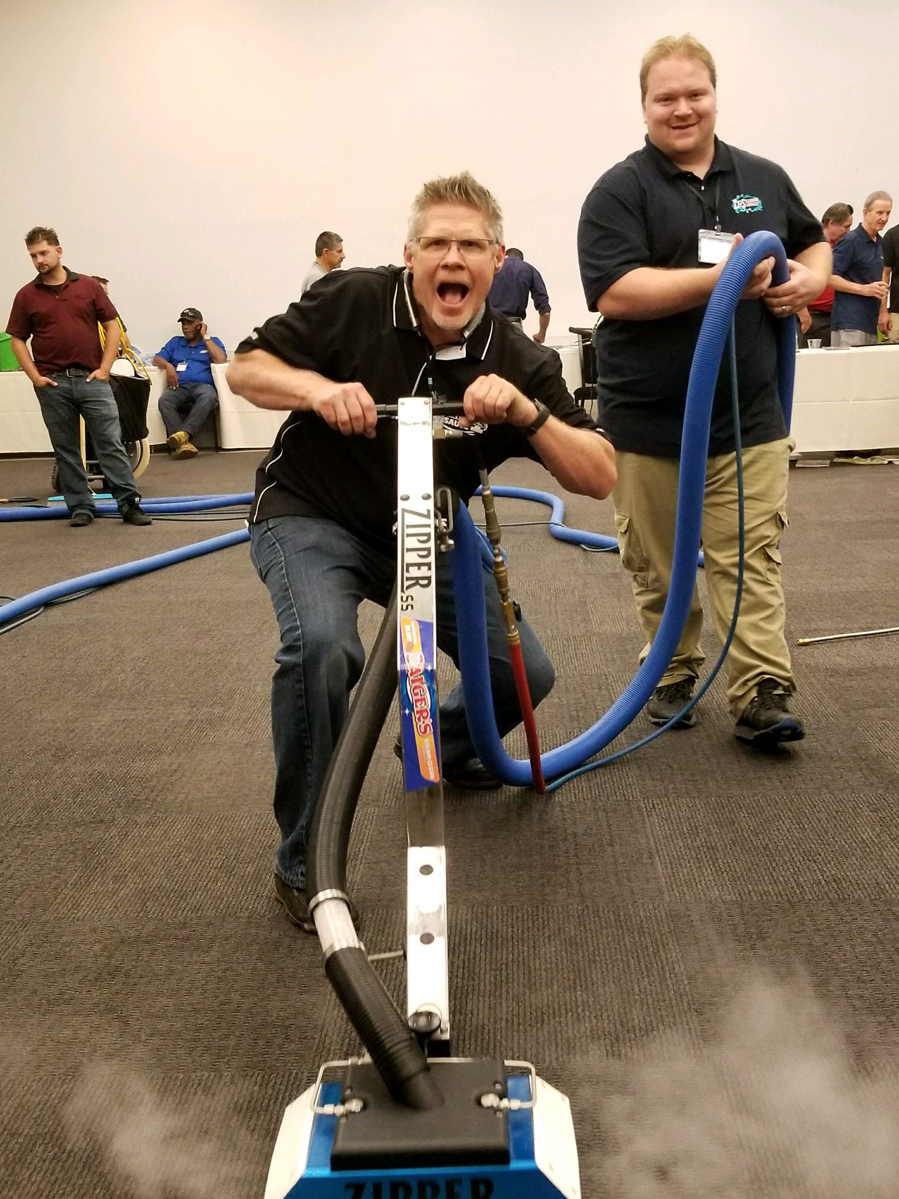

I prefer the ZIPPER SPINNER, It's up and down motion is not much different than mowing the lawn.
Drying head to head? I can't say I see much difference. Maybe it slightly favors the ZIPPER just because you not spending as much time crossing over the carpet.
I wouldn't buy a ZIPPER for dry times only. I'd buy it because it flushes like no other. I'd buy it because it's easier than humpin a wand. It also doesn't require a power cord. Which may sound minor but fookin around with a cord can be a pain. Especially if you ever get it near the head while running. :shifty:
