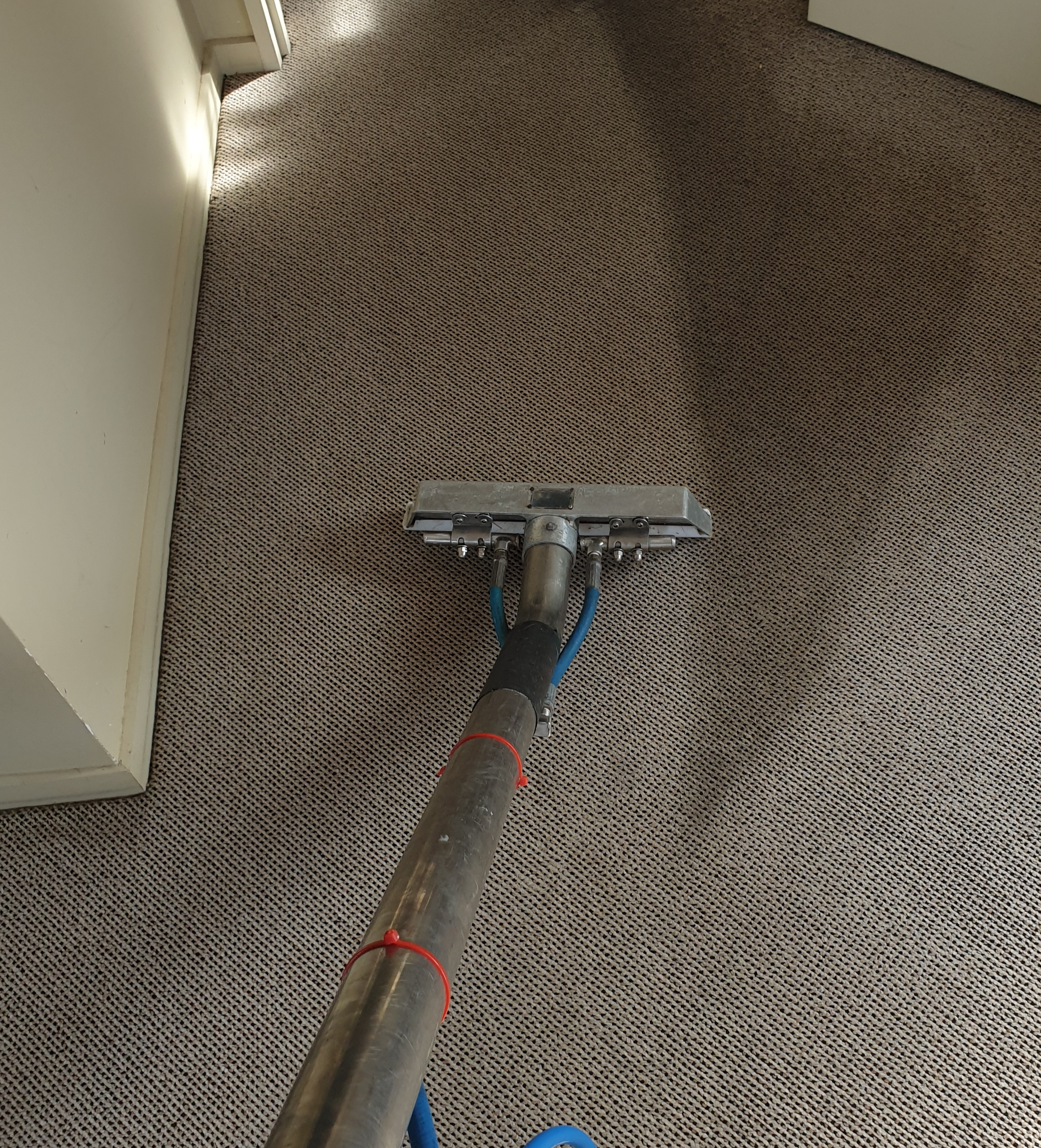

Dan
It's a devpro..
how much involvement Tom had with it I don't know?
