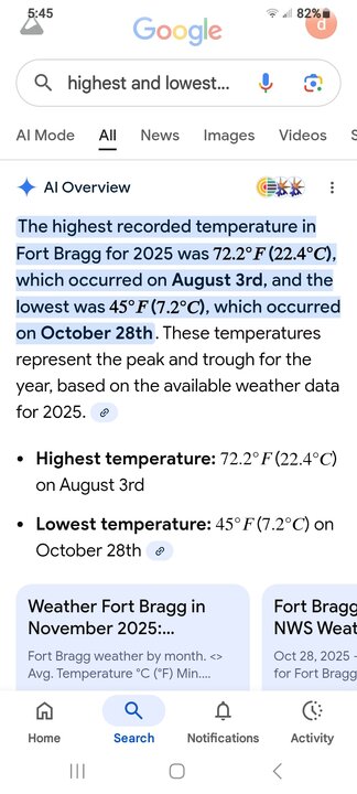

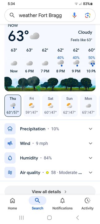

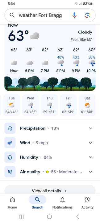

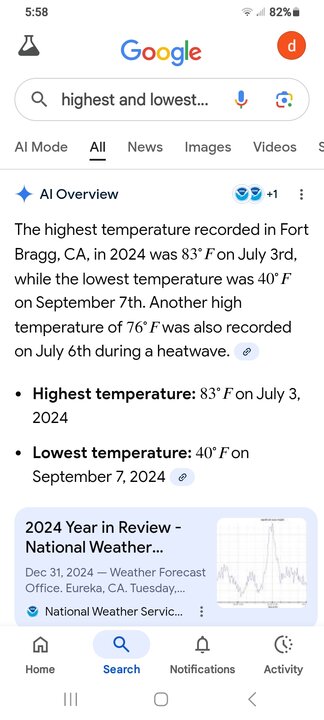

If there was ever a good reason this is why Dwaino lives on the coast!
