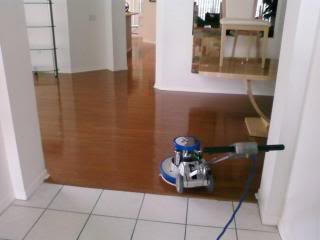

All of these are cleaned with a neutral cleaner & buffed with a microfiber or cotton pad..!

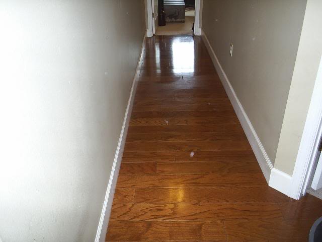

This cleint recieved 3 estimates...That his flooring "MUST"have a sreen & re-coat process... :roll:
He "Labored " over the decision for weeks...!!!
He was impressed with our company..&..was horrified by the apperance of the competitions employees that had given him estimated..!
I told him we would come & DEMO an area...then He could decide... 8)
This gentleman "LiGht-In-ThE-LoaFerS" wrote a GREAT review on Angies list for our company... :wink:
You Decide.....

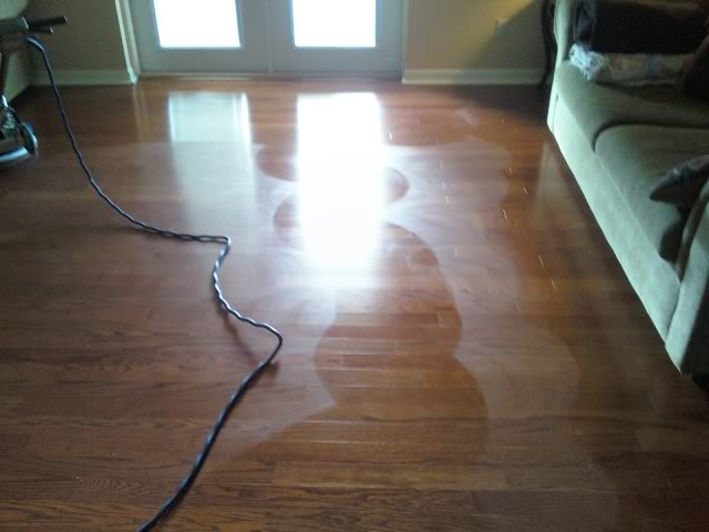

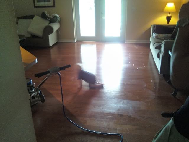

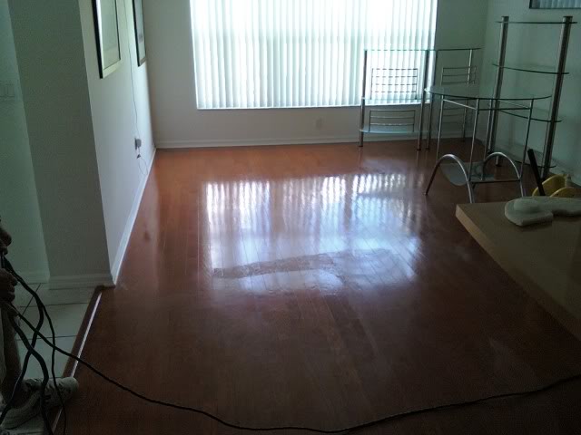

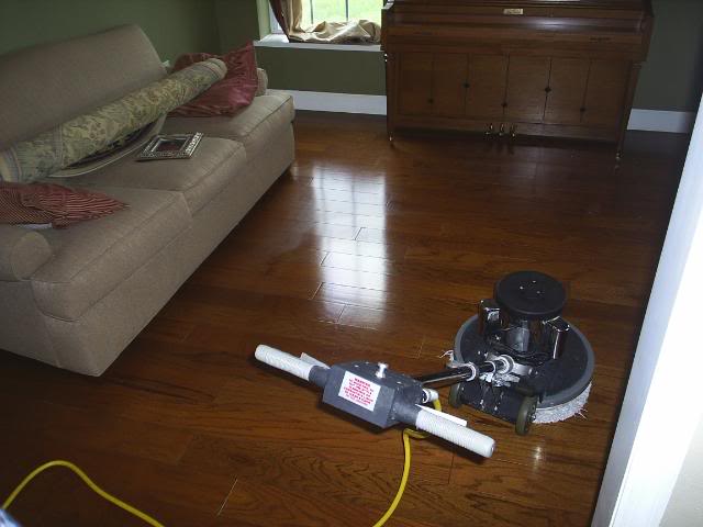

Al said:
Thanks Harper, what speed is the buffer you use?
They are standard 175's...
I would not recommend a "high Speed" burnisher ...if you are not experienced...
If you will notice in the photo's...there is a white haze on the floor.. :!:
If you allow the Neutral detergent to haze..."very similar to waxing a car"
The impurities..are easier to remove with the DRY bonnets... :wink:
This way the bonnets...DO NOT..gum-up... :idea:
Ps Do small areas at a time...The same way you wax a car..roof,hood,trunk,
quarter panels etc....etc... :!: If you have ever put wax on an ENTIRE car &
then tried to remove it all at once.. :oops: You know what I mean.. :wink:
