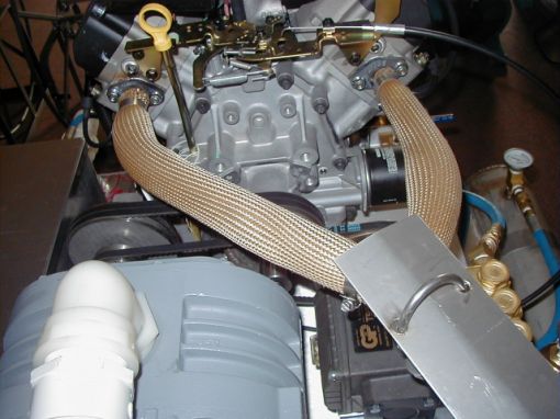

Larry Cobb
5,795
Larry Cobb
John;
Exhaust wrap is "old school".
Exhaust tubing gives you better insulation and less heat loss:
It also lasts longer than the wrap on this Kohler 31HP engine.
Larry
