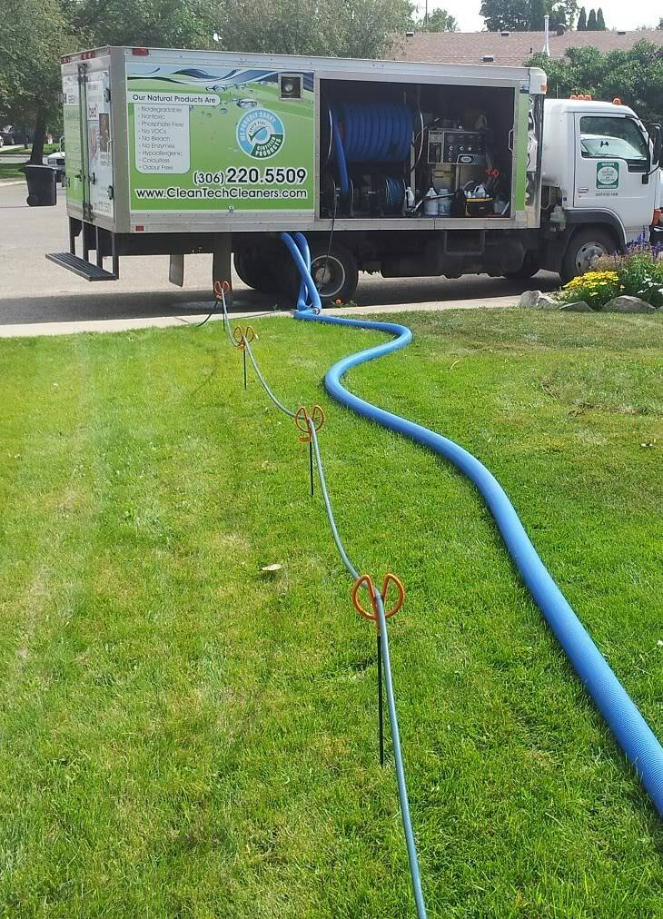

Or just make your own. Take a 2 foot piece of rod, bend it at about a 30 degree angle about 3 inches from one end, weld a 3 inch piece next to it at the opposite angle, paint it yellow and you have a really cheap one.
Looks like this one could use a new coat of paint.

Parflex is cooler because it's insulated, but can still leave a trail.
