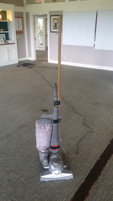

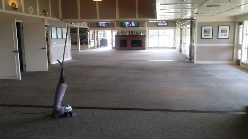

Zipper and the Cimex head to head...
112,660
Unlike Saiger's Prima Donna jobs, we have to actually vacuum our restaurants..
Attached a broom handle to the Kirby to speed things up..

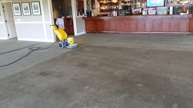

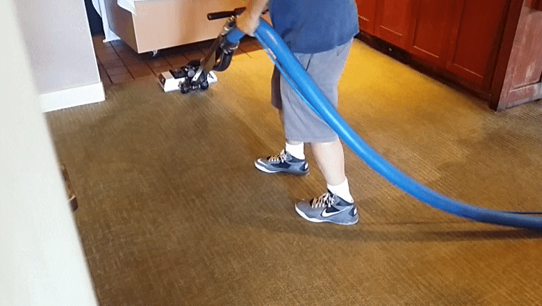

To the left of the Cimex was all Encapped, to the right was pre scrubbed with the Mex and Flex and Chemspec BioSolve then Zippered. The right side was more soiled but the final results we near equal. The Cimex'd areas looked a tad better though when wet.
We found our competitor in the closet..
We've done this job many times and today was by far the quickest due to the Zipper.
and the Biosolv..

yes, that is correct Shorty
Some areas were Cimex'd with Releasit DS2
Some areas were pre scrubb'd with the Cimex and rinsed with the zipper
and some of those areas were then post encapp'd with the CimexDS2 again..
The "just" Cimex'd areas were taking a lot longer as the carpet was pretty bad this visit.

But the sad fact Mikey is that the zippered areas were HWE restoration type cleaning actually removing the soil load.
And the cimex areas although were fast, easy money, with the initial PREVAC being the actual only soil remover.......the fact is.............it's an appearance management cleaning. And with most of the soil load STILL in the carpet it will soil much faster than the areas that you HWE with the zipper.
And it's pure folly to expect the janitorial staff to vacuum up that PIXIE dust when it dries. It just won't happen.
So in essence the only way to clean that restaurant is to HWE it.
These are the facts......anything else is BS.

We've split this job like that many times
No indication that the Shampoo'd areas are resoiling quicker
But I agree with you in theory

Logic was tell you that's what would happen but experience tells you a much different story. I've heard the story over and over from clients that like the appearance and love that its stays "clean looking longer".
Although saying that, we still HWE the worst areas to remove soil load.....then Cimex to make it look better! :errf:
In situations where HWE is not practical for distance or multiple floors above ground level then we OP and Cimex.
Now I want to add more Zippers to speed HWE on commercial and have less wear & tear on the tech's too.
