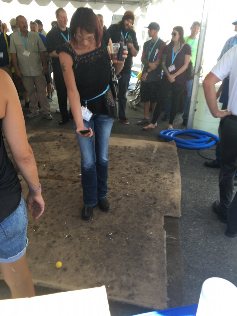

Get a 15 crb or at least the 10inch, wands are wands they squirt and suck.
I wish Mike would've busted a 360i on this
Reg with his crb made this rug look better then a aero tech and super spinner.
Mark needed to vacuum it first or crb a little longer.
Of course a carpet like this is the exception not the rule.
