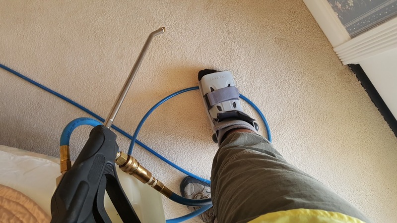

I'm no poser..

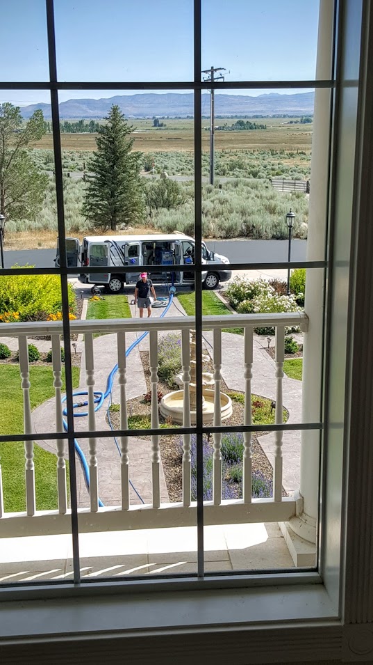

there's my Aron..

I have an Aron.... :)
