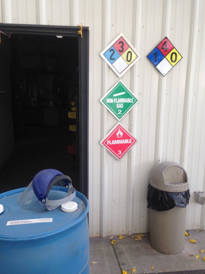

You need to let your local fire marshal know that you have your drum and have a designated storage place. We do an annual Tier II EPA report (ingredients over 10,000 pounds) where we have a map of our location designating where our hazardous materials (including H2O2 25%) are stored. We have an explosive room where we store all of our solvents below a flash point of 100 degrees F and for solvents which we have alot of stock like d'limonene. In case of a fire we do not want firemen going into an area unprepared.
GeneMiller
Mar 24, 2009
3,541
Boca Raton
gene miller
I keep it at an industrial plant. they have far worse stuff including a couple of containers of mercury.

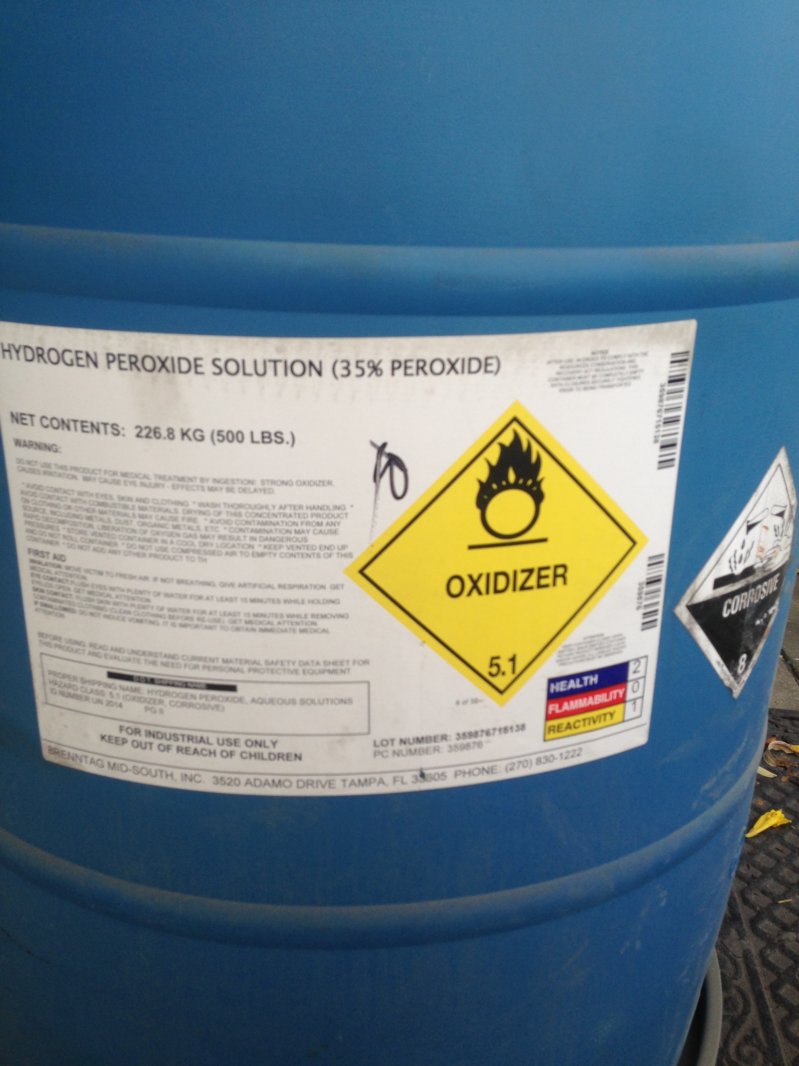

GeneMiller
Mar 24, 2009
3,541
Boca Raton
gene miller
this is how i buy it.
Reactions: Foothills Phil
Able 1
Apr 12, 2008
6,469
Wi
Keith
That's awesome!! How much is a drum? I worked for Brenntag(as an employee)here and clean one of the managers carpet regularly.. Good to know!
