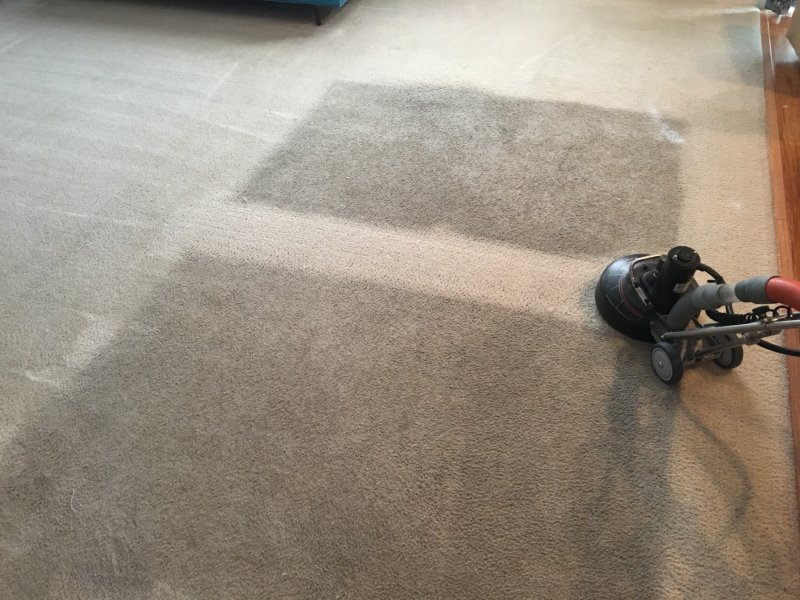

Loren Egland
Just did this job a couple days ago.
