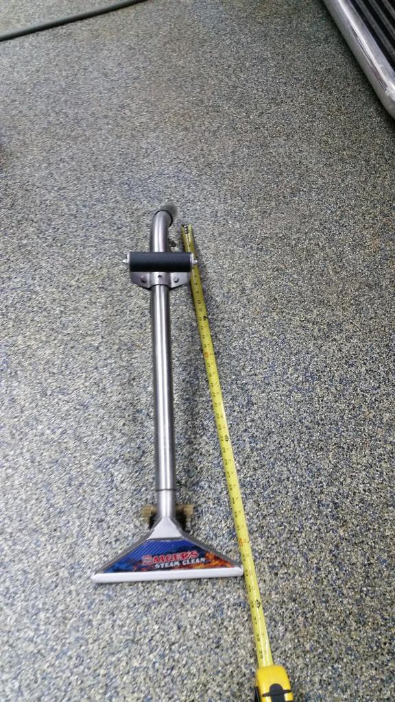

I think it is time for a new stair tool.

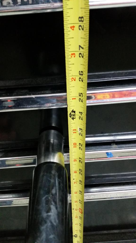

Is that 30 inches??

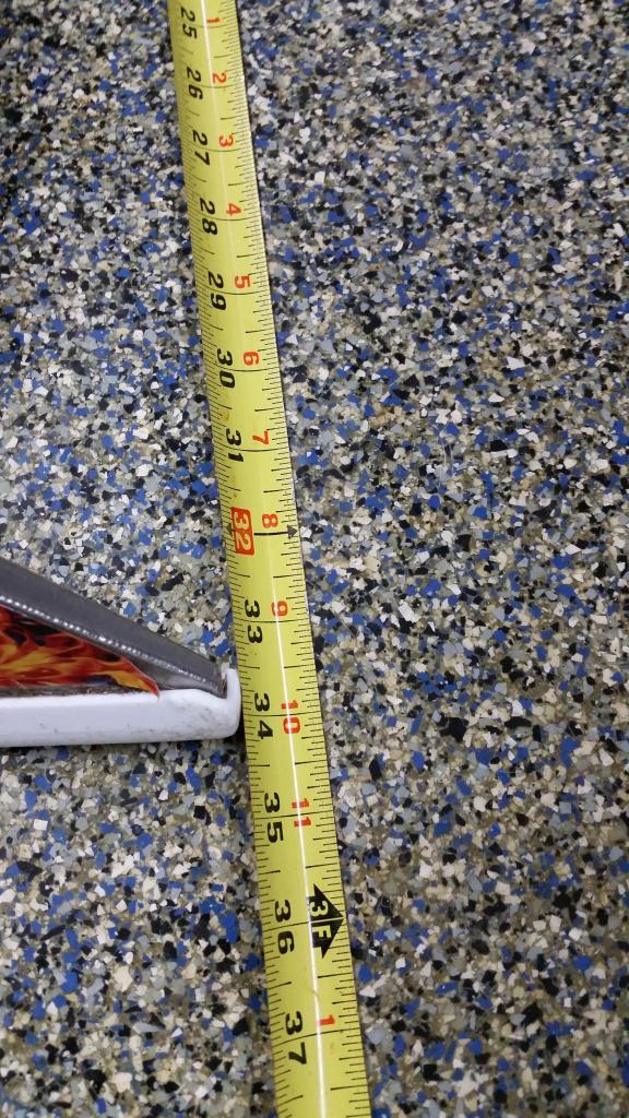

I went out to the shop and measured it and am sending some pics too...
Standing leaned up against the tool kit and at the angle you would be able to clean at, it is about 23 inches from the floor.
Laying on the floor, it is about 34 inches long. It is a 1.5 inch diameter tube. We just throw a whip on it. The only hose we reduce down. Tried reducers on the end of the 2 inch, but just like the whip better. Doesn't work us and beat us up....
My Son in Law is about 6 foot 5 inches and finds this wand comfortable and fast for him. I am about 6 foot and feel comfortable with it as well. Here is that video link again of Him cleaning with it.[/B]

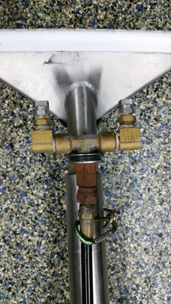

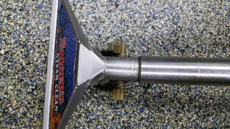

Yep, PMF stair stool, but I had it made into 2 jets instead of one jet.
Found the sweet spot with the jets in the pics.
We do like the swivel for steps....but nothing else!
John Olson has set them up for me.
