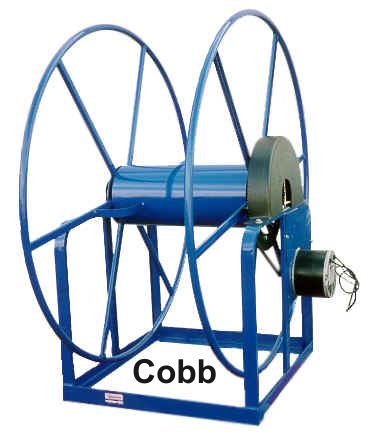

Able 1:
Here is a picture of the same chain-drive reel set-up that we used to convert a std. reel to electric:
I don't remember the exact cost for the parts required, but Jay is pretty close.

Nice looking reel Larry!
After looking at Albert's I am thinking I'll have to go with a 400rmp motor... Actually I'll probably go with the same size sprockets also... or I'll end up buying alot of different sprockets to find the right size to convert 400 rmp to a usable speed for the reel. Don't really know if it 250 rmps would make that much of a difference with a sprocket that small.
