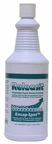

What about encap spotters? Just mix DS2 to recomended ratio? OR?
Encap-Spot will serve you well. Covers a very wide range of typical carpet spots. And since it's an encap spotter, it doesn't require rinsing. Give it a try, I think you'll become a fan! https://www.excellent-supply.com/Re...tion-Carpet-Cleaning-Products-Encap_p_74.html
