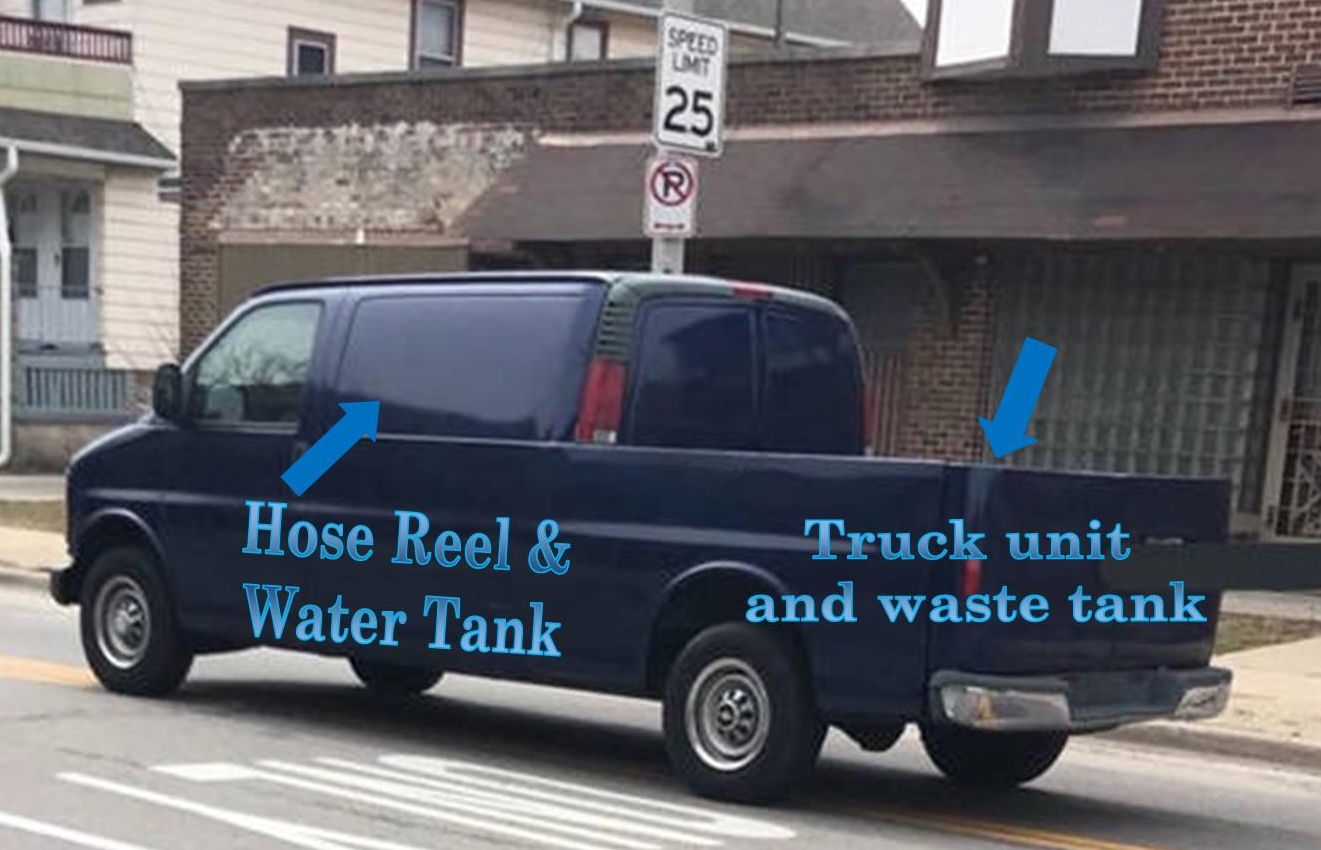

So with the thought of extending the life of the motor we plant to mount a 370 out in the open. Keeping the fresh and hose reel in the enclosed portion. It shouldn't have any heat related issues. Are there any negative you can foresee?

Try and squeeze the water tank outside so you’ll have room for chems inside

Rain is the biggest obstacle but we have a pop top that will interlock to keep it dry in use. Can't drive with it. Won't use it in the snow or freezing weather. All tools will be in van portion nothing else outside to be stolen.
