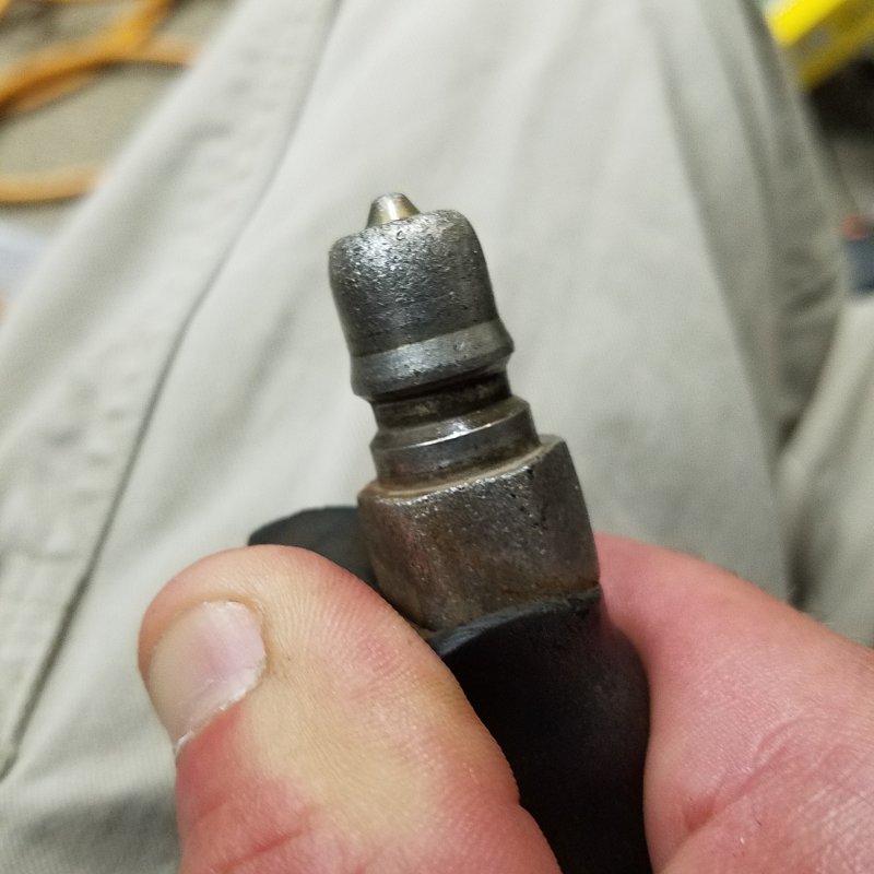

Same here. I try to use only Parker qds. I found the Chinese ones were a little sharp on the male ends. The Parker are smooth and rounded properly.
I like the stainless Foster males.. This one is a few years old..
