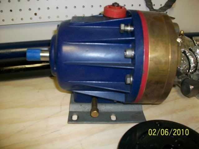

Larry B said:
I wish but no this one has been replaced with a cat pump
won't work...that's why it's pulsating....remember the brand new cat pump i sold a while back....some idiot tried to put it on a Genie.......NOT COMPATIBLE!!!
Cats are piston pumps where as the Wanners are diaphram.......
you'll NEVER get the shakes outta it......maybe a damper will hep...but i doubt it!
Para Plate pressure regulator or brass?
bob vawter
Grassy Knoller
Sep 15, 2007
43,732
La La Land
bob vawter
Larry B said:
Who has the Wanner?
Geeeeee.....let me think..........................................
ohh i do!
