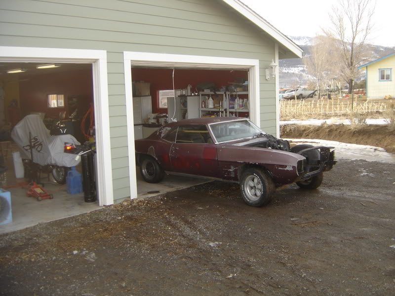

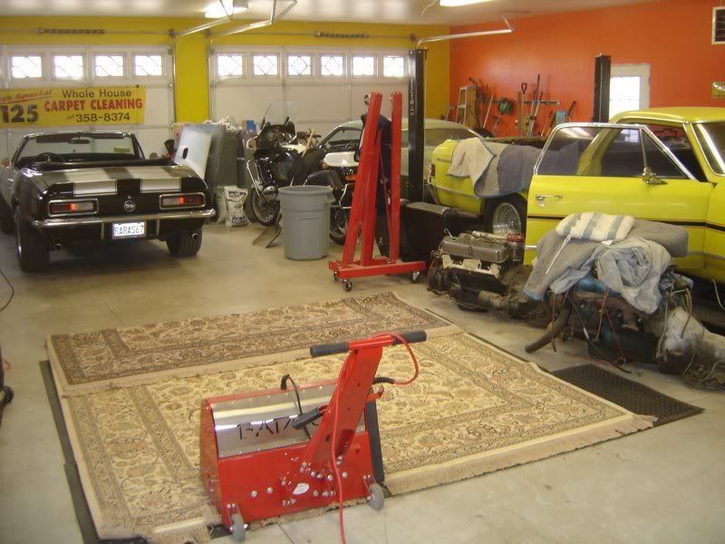

The coldest I have seen it this winter here in Reno was twenty below F...and here is my secret to keeping my 'mount from freezing...I keep it where the Camaro was...and it stays at 48 degrees the entire winter:

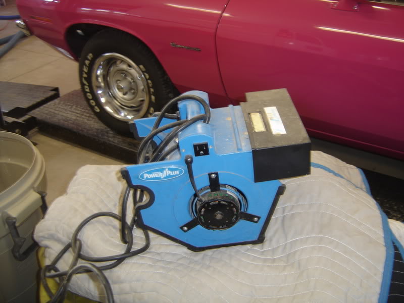

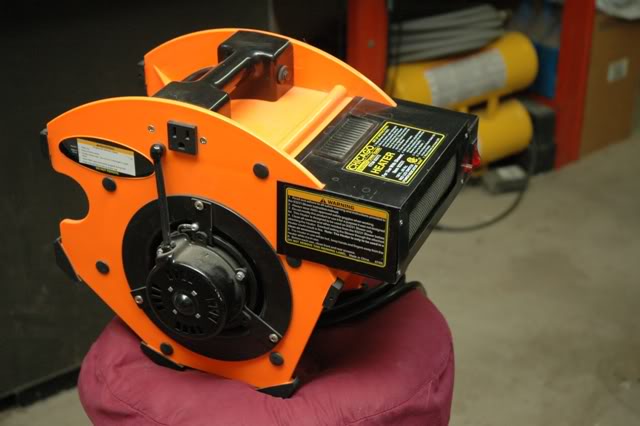

HEATING THE VAN ... there are a lot of heaters for sale that do not cut it for heating the van. You need something that Both heats the air And Circulates it...no wimpy heaters allowed...here is my favorite...a blue blower with the heater accesory...the thing makes 300 cfm of very warm air...and really moves it around...perfect for when you are trying to keep the ravages of winter away from the heart of your business...
http://www.toolsurge.com/prodlist.asp?strSearch=BB-
You can look at Sears.com and check your local store Today to see if it is available...you can get the blower and the heater for about a hundred bucks.
PLACEMENT OF THE HEATER...Oh just throw it in any place....WRONG!...you need a very specific placement on your heater...you want it initially blowing on the truckmount itself! I think it is best to take a couple of moving blankets and drape them over the tm...paying extra attention to covering the face of the tm...which usually is facing a van door that has a window in it...so it could be one of the colder areas...also the face or instrument panel of the tm usually has the most fragile pieces on it when exposed to freezing condions...think plastic Dwyer meters...and small brass fittings...usually not very sturdy when they are frozen.
LIFT THE SKIRT UP!...Ok..so we have the entire tm draped with moving blankets...keeping in mind that the ONE SIDE the heater is going to be blown into needs to be lifted up a bit...maybe 15 inches...to let the heat blow in safely...and also let the heat spill out into the van...AFTER heating the tm.

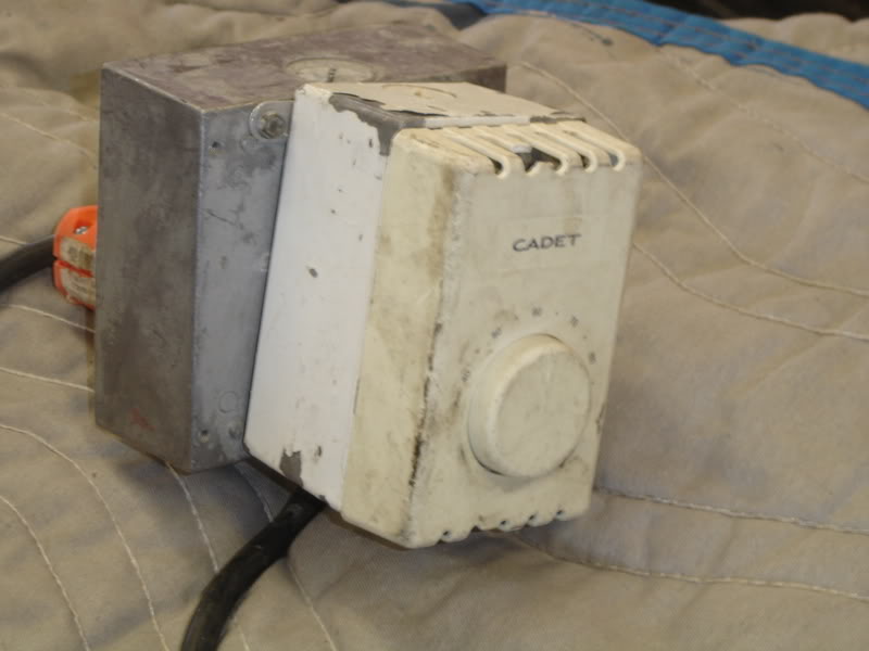

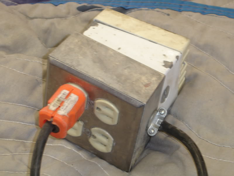

WAIT A MINUTE...THE BLUE BLOWER WITH HEATER DOES NOT HAVE A THERMOSTAT!...Very observant!...Here is mine...
It should cost about 35 dollars to pick up the parts for this thermostat...it is a Wall thermostat for an electric baseboard heater..http://www.homedepot.com/Building-Mater ... 0053...and a box with a couple of duplex outlets on the back side.
Where Do I put the thermostat? Right on the tm you are working so hard to protect...and it controls the heater that is blowing hot air into the little tent that securely covers your tm.

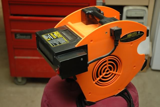

Jim,
Your heater looks almost identical to one I bought at Harbor Freight, except for the color:
You buy the fan and heater part separately - the HF part #'s are 93231 and 93272. The current price is about $70 together.
Also, I like your T'stat - looks like it will get the job done. What do you think about this one (I haven't tried it - live in Phoenix):
http://www.smarthome.com/7143/Thermo-Cube/p.aspx
It goes on at 35F and off at 45F. Placed in the coldest area of the van? It's cheap, and rated for 15 amps (1800W).
