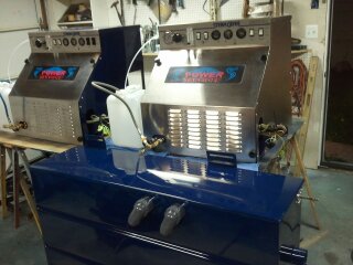

I've got to slide ins, none half as good as a steam genie. If I get the diesel heater working on the latest one, at least it will be hot. still about 2 weeks away.
