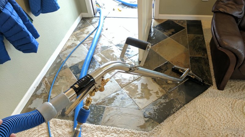

lots of hard surface today, gave me time to think..
112,730
of just how potentially bitchen our new MTM PMF wand is going to be..
very excited to quote my buddy Mason.
This is the old PMF HS wand, while "good enough", it's about to become obsolete.
This job was a perfect example of where a wand outshine a Spinner
Water based topical, nine years old, no dirt under the coating, they nor I want to strip it off.
Mop down Procyon, CRB, wand rinse at 400psi, no damage to the topical but clean as can be.
I'll go back on Thursday to apply one more coat of topical to coat where it's worn a bit over those nine years.
run that 700 psi spinner over that topical(and soft slate) and guess what happens.
