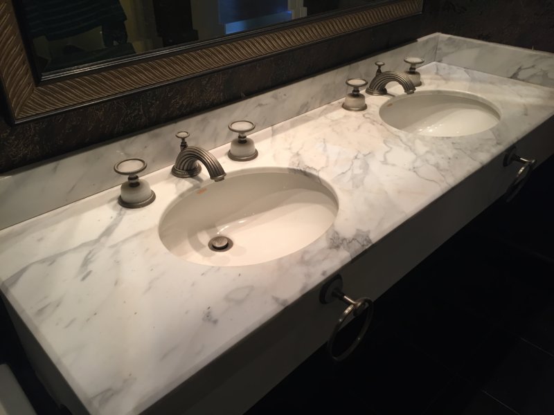

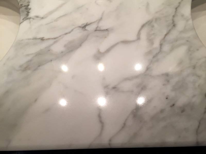

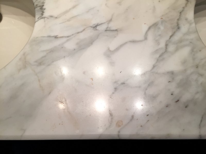

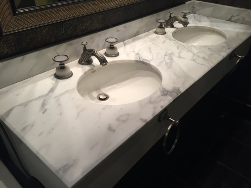

    IMG_1921.JPG IMG_1922.JPG IMG_1926.JPG IMG_1924.JPG I polished this countertop with 400-800-1800 grit, then Dynamite, using a flat felt pad. It is much improved, but has a slight orange peel look after polishing.
    I wanted glassy smooth. This is my first try with Dynamite, rather than MB-22. What did I do wrong?

    I'm not well versed in this stuff, but did you just use the grit or was there any type of polishing compound or other product applied that would add a gloss?
    When we polish granite, we use a product that we wipe on and wait for it to dry/haze (I liken it to car wax) , then polish with steel wool then buff with "lamb wool" looking pad. It really brings up the shine. I realize this may not work for marble, but I would think there has to be something like that out there. I'd love to know more about marble options as well.

    Dips or resin pads?

    Looks like statuary Carrara
    Looks burned.
    Will assume use resins. If not .. That's your problem
    22 is your answer
    Gonna have to re hone and start over
    Welcome to stone...... I have done some that polish normal powder, some that are more like Thassos and burn super easy. And recently had one needed it super hot to blend frames
    Next time , if not sure , just do small section and inspect....
    Also 12 work good
    Sometimes we use diaglo after to pop further

    Yup, resin disks. Got it nice and flat, but perhaps the Dynamite is too hot.
    I may redo it tomorrow it there is time.

    Just what Carl said, if you use Diaglo/ Diamond Renew make sure you neutralize or use the non acidic stuff like MB 22

    Sometimes the Carrara/Calacutta/Statuario stones like this will burn and orange peel and there is nothing you can do about it. other times they will be nice and glassy. The line between variations of these stones is so small, you often can't tell until you're nearly done.
    Dynamite isn't that hot, but you said you're using a felt pad? Like a firm, dense felt pad, not a white nylon pad? If so, that could be your problem. Felt pads generate too much heat.

    Aha. Thanks, Cameron. I tried to stay wet on it, but next time I'll use a softer pad and keep it cool too.
