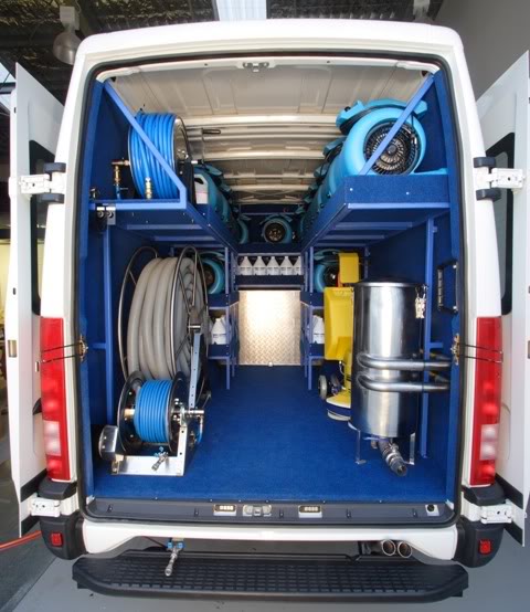

More installs as requested...

Very nice installs on both trucks. I like the idea of using more Stainless.
I think that since the equipment costs more over there, that it is installed and maintained at a higher level.
I like the tilt-out feature on your inline filter. What was the cost of just the filter?
We had a line of NSS tank vacs that emptied the same way and customers liked that feature.

The only thing I don't like about the filter, is how HIGH up the vacuum connections are, I see that being a problem. Other than that, I want an external filter badly.

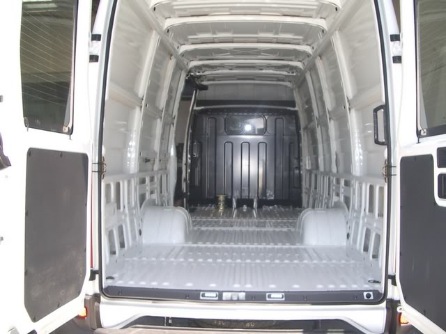

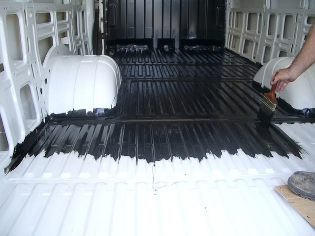

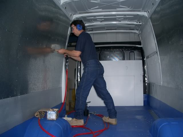

I'll give you a quick run down of our installations starting with a new van
We then rustproof the floor
Fit marine grade ply and screw that to the floor.
Fit insulation into all of the wall cavities
Cut Zinc sheeting to size and rivet it to the cross members of the walls
Apply marine carpet to floor, walls and doors. Measure up and start fabrication the custom racking and auxiliary tanks
Before it gets completed and loaded before it rolls out of our factory...
If you have any other questions Patrick, don't hesitate to ask. :)

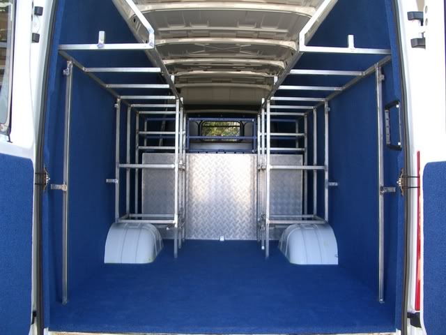

Here are the finished photo's of the rig that I partially posted earlier. The Stainless racking and wraps have now been completed. On board currently there is 2 dehums, Cimex, 22 air movers and still a lot of space left over. All the racking including the chemical lock box is stainless. Came up great!
Side view showing the PowerClean Diesel D-XT Genesis.
Finished off including the wrap.
Jim
