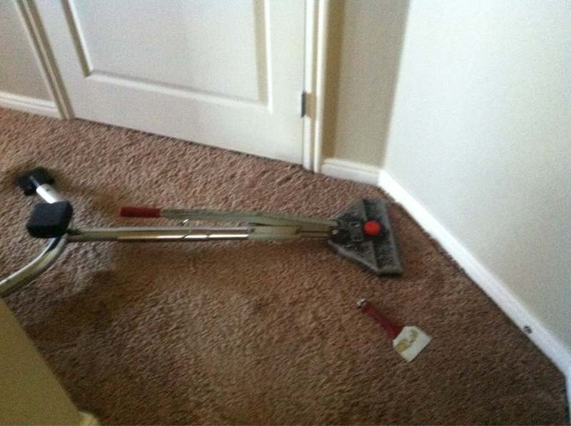

I have also been able to stretch some difficult areas a lot easier with the Tri-force.

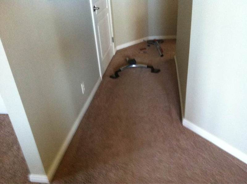

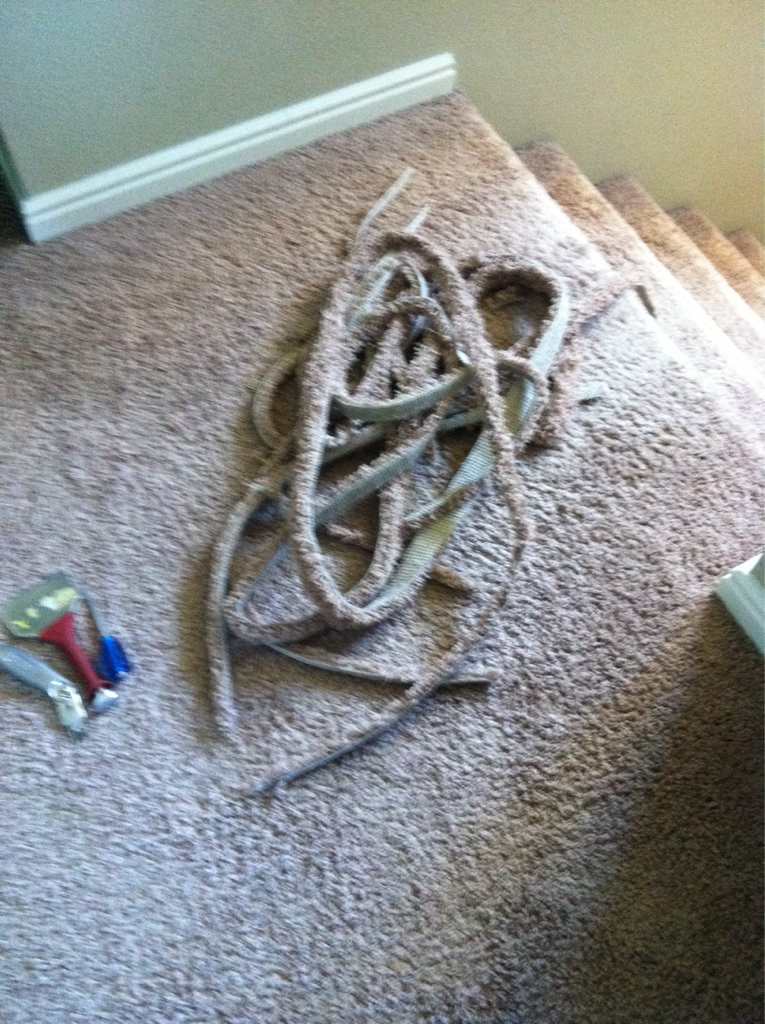

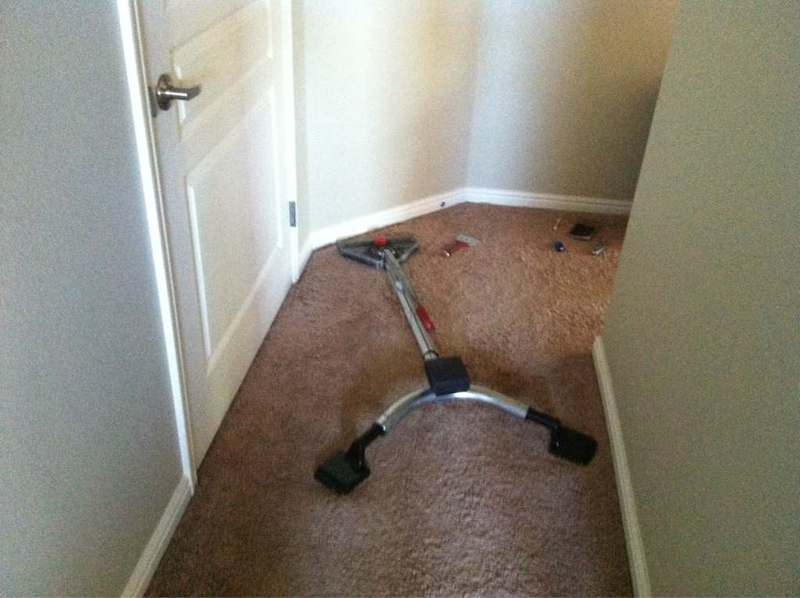

This hallway did not have a good wall behind it to put my power stretcher on. With this kind of a wrinkle I normally would cut a seam, pull it together with my crab stretcher and then reseam it. I was able to do this without cutting the carpet because I didn't need a wall behind it.

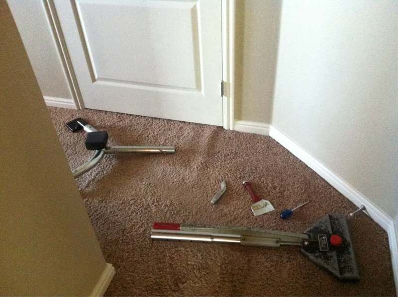

Transition repairs are easier to do, especially if it has an awkward angle or bend to it. Sometimes if there isn't a good wall behind it, it can be hard to stretch it back into place.
These ones can be a PITA. With the Tri-force you can work right around the bend and not have to move the furniture behind it.

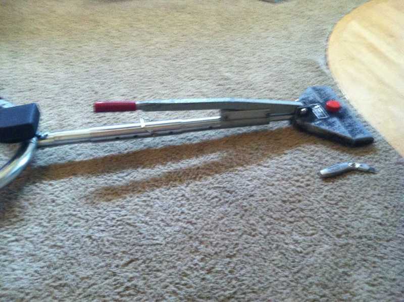

Thanks Charlie, I can see from the picture that you attach the powerhead to the "triforce".
However, I assume that since there is no poles run from the opposite wall that the stretch generated will be less than the traditional way. After all there is only that much stretch that can be generated from a 3 feet area compared to a much longer area. I can see the advantage in smaller areas and also in avoiding all the issues associated with a long pole. Though I do wonder if the end results (due to less stretch) are more likely to re-buckle sooner.
It could be that the local stretch generates an over all tightening of the entire carpet. Am I missing something?
Although it is only stretching that 3' or so, after the unit is released the carpet behind the TriForce will then be pulled up.
ie; there would be an equal force all around the perimeter of the room.
That's how I see it.
:yoda:
Bruno can explain the physics behind it better than I can. Using the traditional stretcher, I've never been called back for wrinkles coming back. The Tri-force seems to get the carpet just as tight as the traditional stretcher. So I guess for me, I'll know if and when I get a call back. But I've been told that they haven't had any problems in their R&D of the product.
Ofer,
the stretch is actually from the center of the room, pulling in between the feet and up through the center of the stretcher. It does not matter if it is a 10' room or an 18' room, it only pulls from the center. If it only pulled from the feet forward you would see a carpet bubble all the way across the back side of the feet. It's a long explanation of the forces in physics, but it operates using vector mechanics, in a nut shell, this thing stretches. In over 8 years of use and testing, we have had zero recalls on new installs or re-stretch jobs. The testing showed that when used correctly it stretched almost 30% tighter than other methods.
Shorty is exactly correct, all four walls being stretched with the unit gives a perfectly even stretch. I will be posting videos of re-stretch jobs that I have coming up pretty soon and I will try and explain and better demonstrate how it actually works. Incidentally, the kick test that Mario does in the 12 X 16 test room shows how tight it got the carpet. If you haven't seen the video yet, go to our site www.3force.net and check it out.
