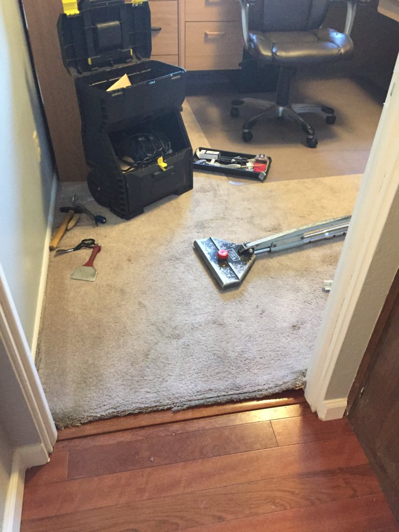

This is a perfect example of a good use for the tri force.
Hardwood installer cut the carpet at the transition. He compromised the stretch in the process. Instead of putting a tac strip along the transition he just put the T-bar across hoping it would hold the carpet down. This resulted in the room having ripples in the doorway (for some reason they aren't really visible in the picture.)
There wasn't a good wall behind the stretch to put my power stretcher on because of the desk and shelves. So the tri force is the perfect tool for this. I had to fix 3 transitions in this hallway. 20 minutes $95.

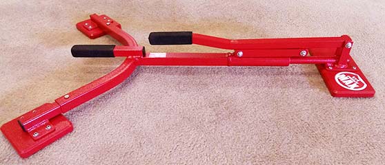

I'll try to chime in once I get back later, but I bought the TriForce Max last year. Seriously this tool is so wonderful. The Max is great because it is so small, from head to tail I can restretch a carpet in the smallest places, that before would require lots of furniture moving. If someone is thinking of getting one the Max is really worth the extra money just because of the short footprint. I really should make a video of how I use mine because the other videos don't show the benefits that I have found when using mine. One thing that most people need to get used to is that the stretch takes place only right at the head so you move it along the wall just a foot or to at a time. Kinda like using a kicker to restretch. When using a kicker you pretty much place the kicker every few inches along a wall. So on a 12 foot wall you might place kick the carpet at 8 places, with the triforce you would place it 6 or 7 times. A traditional power stretcher may only need to be placed 4 times on a 12 foot wall. Hopefully that makes sense.
