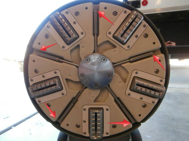

For the Hoss.....
this is all it takes.........

If I understand correctly:
Get all the water bars to be the long ones and not staggered?
I assume it is a pressure regulator?
What kind of time saving do you get (%) compared with the stock Hoss?

If you look close at the picture....all long bars are staggered......this completely eliminates streaking.....
the needle valve will give you finger control for the amount of flow....if you are coming to a really dirty area...open it up and give it more of a flush....not so dirty areas....turn it down......
once you get the feel for this...you can fly with this machine....
the stock Hoss you have to slow yourself down more.....not enough flush for the little jet bars to do there job.......
