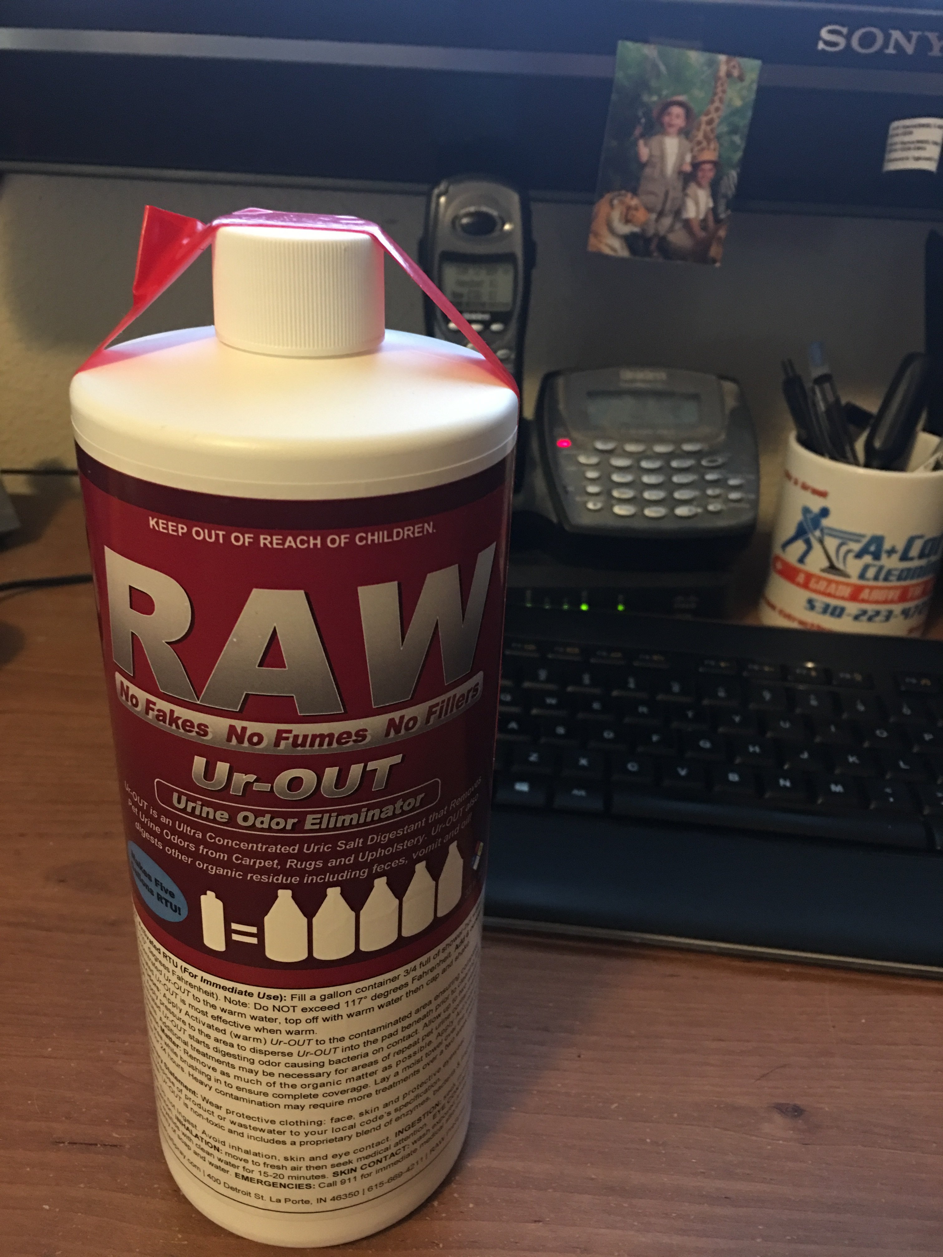

You guys know I’m all about high dilutions. My protectant is 15:1 and lasts forever. My specialty seems to be urine so when I saw this RAW stuff on a FB ad I decide to try it. Anyone have experience with it?
I just couldn’t resist. Look at it! One 32oz bottle makes 5 gallons RTU. 1 gallon makes 20 gal RTU. Truly a space saver on the van. Says it works on urine odor and salts, vomit feces, and oil. I believe I paid $30 a bottle. Let’s give it a try. Bring on the urine! If anyone here has experience with this stuff I would like to hear about it. I hope I didn't fall for some clever FB ad.
