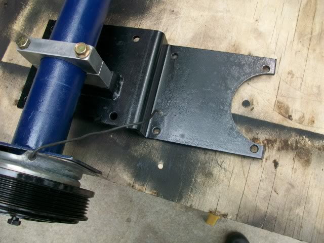

I have looked at that picture 100 times in 300 different directions and for the life of me I just can't understand how the feet bent out would cause the blower to bind.....that thing is pretty ridged and the fabricated feet should really have nothing to do with any thing.....all they are...are mounting points....one thing that I do notice in the picture is that the blower is not sitting flat.....there is a slight taper going up to the right....it also appears that the hole where you took the bolt out is not lined up straight.....and this would also account for the blower not sitting level.....it looks like from the pictures that when it was installed it should of been shimmed level..and if this was the case that would of in time put a bind on the belts not running true and wearing the inter edge of the seal....
on the other picture .the one where you said the heat caused the warp....is that a rubber boot that is holding the 2 parts together that looks like it split....???.....I can not see what is warped....to be honest I have never seen hot exhaust heat up enough to warp metal that thick...can you pin point to me what I am looking at.....

Jim, the legs warped pulling down on the impeller case, when I removed the bolt the blower case relaxed into the correct alignment. The mount is 1/4 inch plate, not rubber. The report on the blower was from a reputable source.

Jim, The rubber is just the flex pipe between the blower and the silencer. I had to cut it off.

and once again I am not saying that he is wrong.....but from what I see and from what you just said....I think the proper shimming should of been done in the first place.....so that when the thing was mounted in place the unit would of been lined up ......It is very rare to see any type of metal to metal mounting that sits perfect...all the huge 3 phase motors and large blower that I have worked on always needed some type of shimming to make the belt run true........level your truck up..then take everything lose......level and shim the thing so it sits perfect...put that bolt back and and run it for awhile and see what happens...........I am only trying to help you out here.....removing the bolt will only bandage your problem....if you want a long term fix.....shim it....there should be no taper........
in a nut shell........when some one is tightening down the mounting bolts and the thing has an air gap in between the 2 metal pieces.....something needs to be shimmed and leveled to keep it from warping the feet and making sure the thing is nice and level..........

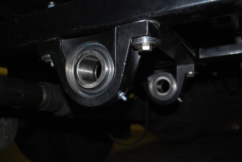

under the truck is the 2 carrier bearings that hook to the PTO shaft.......it looks like they tried to line the blower up to the off set of the shaft...(?)...who knows....almost every single one that was made..except maybe the 777 were done this way.....none of them run real true....the PTO's run on 3 belts.....and the inside belt was alway a bit more lose then the others......you can put a white chalk mark on them and run it one job and the marks will be way off.....that was always a problem with a few that would call me....over time the inside belt would start to squeal a bit because it always ran a bit lose.......so the first thing they would do is crank on the adjuster and tighten the belts up and end up throwing a seal because it was way to tight.............I shimmed the ass of mine up just a bit higher to try to level the belts out....never got it perfect....but never ever had a problem with squealing belts or bad seals......

Jim, If you look at the picture you will see that I am shimming the carrier bearing on the cradle to line the pulleys up. That blower weighs 450 lb, if you tryed to shim it on top of the cradle the legs would not have the full support of the mounting cradle.
but from what I am seeing and reading....your problem was up top .....once that bolt was tightened down...the blower did not sit flush on the plate...one of them..if not both were not straight/flat.......so instead of pulling them together..because of how the foot was made on the mount....the mount just pulled down and left the blower un level....if a shim or a washer was put between the plate and the blower to make up for the difference....it may have saved you a few headaches......it may be hard to tell if the blower is off some where but try putting a straight edge on the plate and see if it is flat or warped.............I am willing to bet that because of the way the mount pulled down......one of them is off.....
