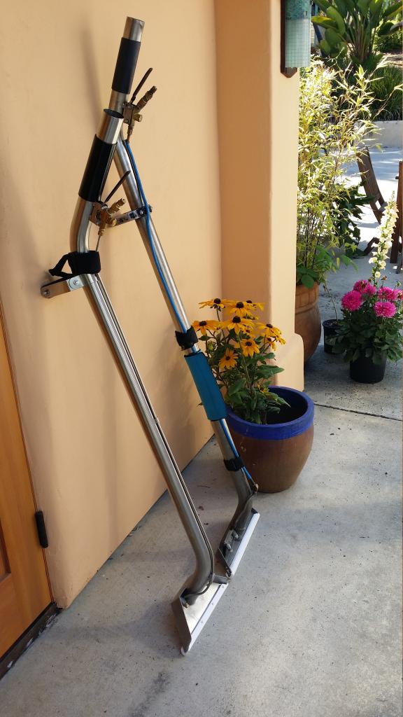

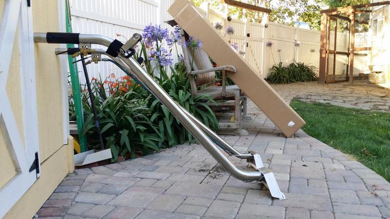

Last week I received yet another new wand to test. My buddy Curt at PMF (who has been very receptive to ideas I’ve had to improve some of their hard surface tools) wanted me to test a new two inch wand and while I was less than excited I told him sure, send it over. He also wanted me to auction one off on MB to help get the wand some attention he feels it deserves.

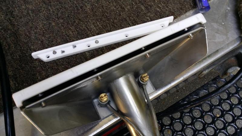

Other than a two piece flat Teflon glide, it looked to me like any other PMF wand. To be honest if it had a 1.5” tube I would have told him no thanks as I already have two regular 802 wands in my barn for portable use. I hate using them as they feel like cheap little boy toys.

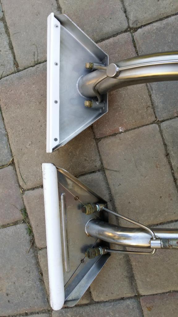

Now if you look at my comparison photos we can all agree that this new wand does not look like anything special. A measly 6 flow output when anybody who is anybody on the Boards wouldn't consider using anything less than 12 flow. No attic space on the head to increase airflow, no ergonomic handle, no exotic materials, no pulsating jets..
So I was shocked to get through my obligatory 9 square feet of testing and find myself wanting to use it some more. 1200 square feet and a staircase later I was in in love. While it feels to be the same weight if not more than the TI, it actually handles much lighter. With it being close to a foot shorter and 2 inches narrower in the head, it’s a joy to use in tight bed rooms and around furniture. The balance is just right and amazingly enough my and my tech’s stroke is just the same length as with the longer TI wands.
We always clean as much of a staircase as we can with our wands then follow up with an upholstery tool. Many and most cases we can completely clean with a TI assuming that we don’t have to back into a wall at the bottom step It’s torture on shoulders, necks and wrists but with time you learn to grunt through it and reap the benefits of full flow and lots of suction. Using this new wand made today’s 3 stairs cases ridiculously easier. Just awesome!
Before I even used it I went on the hunt in my tool box for larger flow jets. Just no way could a measly 6 flow flush like I was use to with my TIs and Rotary Extractors. No luck finding 04 or 05 jets and boy was I wrong. It cleaned great as is. 6 flow and a 12 inch head…lol

Two piece screw on glide
Compared to my custom Titanium
Compared to a AW29
