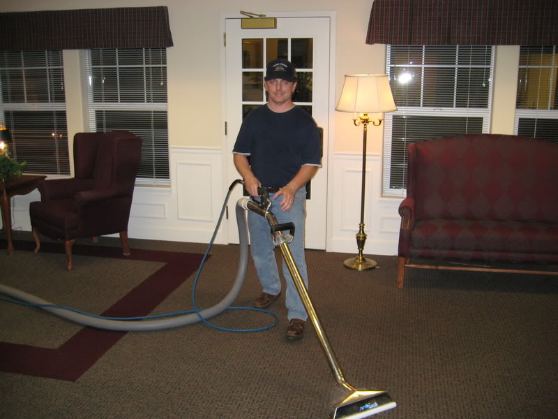

My first carpet cleaning video. Filmed with my Blackberry. Carpet was black! Client was excited as you can tell.

Are you really serious?
Dude, that thing on the tube is callt a HANDLE and it is meant to be pushed on...
a one armed wand pusher bangin' the wall and not crackin' the lips at the edge.......
i can't stand this...will somebody jus friggin' shoot me....PLEASE?

If there is one thing that I ACTUALLY agree with bob on besides a steam genie being a good unit is.... you should do the perimeter FIRST, so you don't has a chance to mess up their walls/baseboards.
Good results though!![/quo
Did the dry stroke afterwards It's a Blackberry phone, Limited Video record time. And yes I run the wand along the edge at a angle. I know how to work and wand. I was trained by the worlds best.

I was kinda cringing every time you slamed the wall, but to each his own.

Keep in mind Bob does provide glides so his chimps have to lean over the wand to keep it from chattering and to get some of the water and mud out.
if you use a glided wand it won't matter which way you pull against the baseboard but if you want to get into the very edge of the baseboard you need to tilt the user end of the wand toward the floor so the vacuum holes of the glide will actually vacuum along the baseboard

the banging on the walls is a little disturbing in front of the customer

slow that wand down on the keyed back stroke and you won't have to make TEN PASSES over the same damn spot.
you're also leaving a LARGE puddle at the end of your keyed back stroke.
