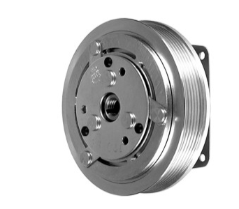

Well, my 1998 Lima Bean Special makes a screeching sound from the clutch pulley for the PTO that is mounted on the engine. To quiet it down I sprinkle a little Bar Keepers Friend on the pulley and that works for a day or two. I'm not going to keep sprinkling this stuff on there, I need to fix this. I'm not sure I got the correct part but I ordered a new electric clutch pulley from NAPA online Part #TEM 948435. It was $179. SteamBrite wanted double that. Anyway, I'm kinda guessing that this is the correct part. Can anyone help me out for sure? My van is a 1998 RamVan 2500 with a CDS 4.8 installed. @anon , @Pioneer Floorcare

My cleanco uses a Pitts clutch #14194 100 foot pounds

Yes they do, they hide the part number so you're forced to buy from them. But after some digging it looks to be a standard GM electric clutch that is used on their a/c systems. It looks like what is mounted on the engine of my Dodge.

You guys really aren't mechanical are you? Do you ever add graphite to a squeaky door? Are you familiar with how a bearing works?
This is how I "Fix" the squeak. I fold a small piece of paper in half. I then pour a couple of ounces of Bar Keepers into the fold. I then line the paper up with the crack of the pulley and flick it into the bearing. It stops the queek for about a day. I guess the previous owner did this all the time but for me it's not an option. I want it fixed. I'm replacing the pulley. The problem isn't the belt slipping, it's a bearing. Replacing belts (Which I already did) and cleaning pulleys isn't going to fix this.

It looks like a really simple replacement. Should only rake me an hour.

My clutch died on a job that was about 2 minutes from my uncle's house. He's had a CDS the last 20 years or so and was able to swap it out in about 15 minutes. It looked easy.
