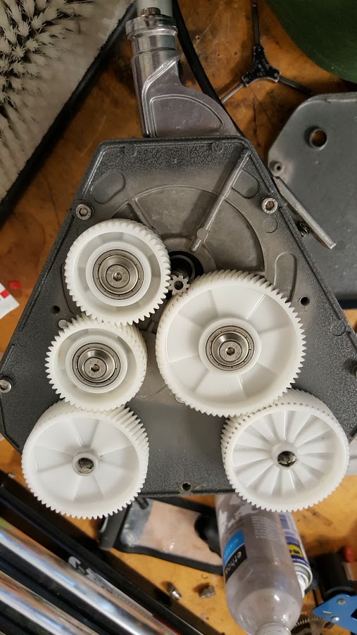

Gear box..
ZDkV-PZorSVtFyRSRWs4T6BI-h3OUrOi_sAqhyaE6BZsw35NT0MsSZ3gIwYI-iE7JU9KCmPGNFA=w508-h902-no.jpg
While not sealed I just can't see pre spray getting in there unless a careless tech used a HF to wash it down at the end of the job/day

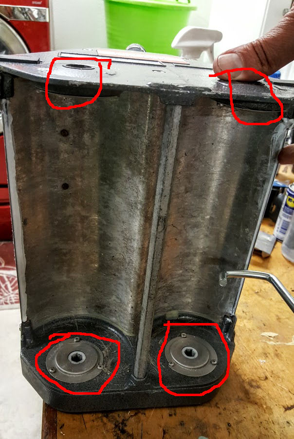

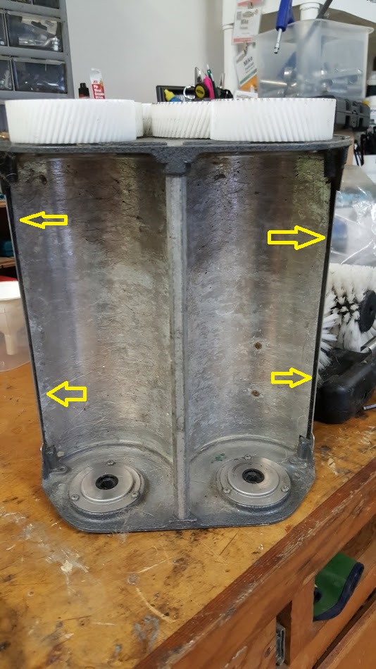

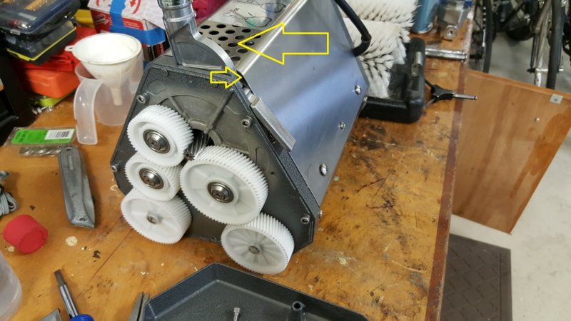

Only open areas I can see where possible splashing could get in but all the guts and motor are up high, so again, the corrosive liquid would have to be sprayed in there, while the machine was upside down..
Arrows pointing to areas where liquids could get in.. But not during cleaning...

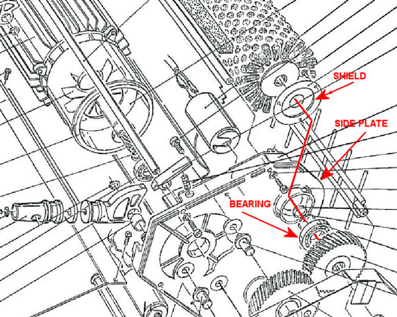

This was a situation where extensive metal corrosion resulted in bearing failure
The gears were not at issue, it was the bearings on the lower gears that drive the brushes that had seized and could not be extracted from the side plate.
There are ball bearings here (four places). They are covered by metal shields, but they are just shields, not seals. Under the right circumstances, say if solution had accumulated between the shield and the bearing inside, and then you pressure-rinsed the brushes, I could see how the chemical could be driven inside the bearing(s), eventually corroding them and eventually seizing, in turn causing gear failure. These are the areas pointed out by our intrepid mechanic where failure occurred, I believe:

Your machine looks like it's been taken care of Mike. Gears look fine and I see no evidence of any corrosion. Keep doing whatever your doing
